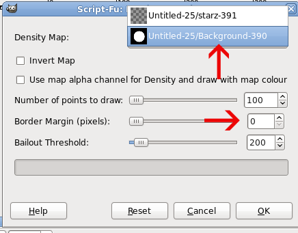

lol ... now it keeps telling me the density map has to be the same size as the layer?
I get that message if I change the Border Margin setting to something other than zero.
You should have two layers.
The top layer is either white or transparent. Make sure you have the top layer selected before you start the filter.
The bottom layer is the density map - black bg and white shape. Make sure you have it selected in the Density Map dropdown (what is the 'official' name for that dropdown?).

Ahh must be the border margin thing then, although i think the default settings has 0 for border.Not sure though.Ill try again. =)
Thanks O!
