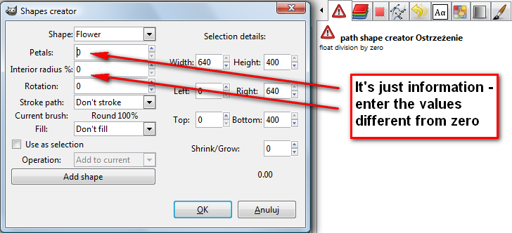

MareroQ wrote:
are there still bugs in arakne?
downloaded ...creator6a
when I launch the path creator on a new image, I get a heart (default)
if I only just change the shape to -let's say- star, I immediately get:
path shape creator Warning
float division by zero
list index out of range
 Post subject: Re: Gimp Deco
PostPosted: Tue Jun 10, 2014 11:02 am  (#10)
Additional info (made some other tests):
these are the shapes that - when selected - produce a gimp error on the console:
-flower
-star
-gear
-arc
-spiral
-cross
-polygon
all the others show up
in the folder "shapes" all are in, both those which show up and those which go into an error.

PostPosted: Tue Jun 10, 2014 1:21 pm  (#14)
Hi Diego - for me it's just information.
When you enter values ​​are still not working?
The actual small mistake, however, occurred (for squares and rectangles - the option Corners: "Rounded inverse" and "Chamfer" stopped working - was reported to the author).

PostPosted: Tue Jun 10, 2014 1:38 pm  (#15)
Very interesting Mareroq!
It seems that the plug-in starts working without entering OK.
So, in the example you asked:
1-changed shape (w/o hitting OK) = errors shown
2-entered petals > 0 (w/o hitting OK) = errors shown
3-entered radius > 0 (w/o hitting OK) = errors shown
4-entered rotation > 0 (w/o hitting OK) .... et voilà the flower!!!
What's the matter?
PostPosted: Tue Jun 10, 2014 2:01 pm  (#16)
Sometimes (rarely) it happens (at startup) that a shape is "resistant" to change a specific parameter - that I click another (changing value) and it starts to work without a problem.
A small drawback - but the possibility of the plugin are now Excellent.
PostPosted: Tue Jun 10, 2014 2:06 pm  (#17)
yes, but: is it "natural" that without entering OK the plug-in starts working?
it's not usual, for me, at all.
do you know other plug-ins doing the same?
or - even better : do you know how to avoid this behaviour in this plug-in?
