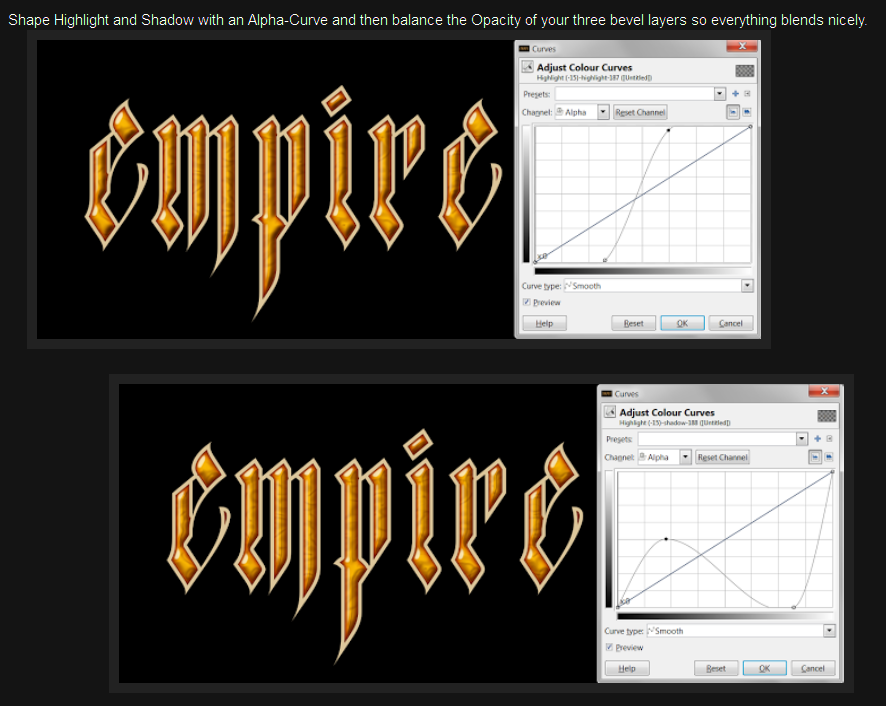

One thing that I had issues with was step 09., shaping the highlight and shadows with an alpha-curve.
I could not select 'alpha' in the curves dialog on any of the highlight or shadow layers of the bevels.
I had to merge them together in order for me to apply an alpha curve to these layers.
This is a screen shot of what was causing me the issues.
Everything else went smoothly, until this step. The number of layers you say is three and I applied 2 separate bevels, each with a shadow layer and a highlight layer making that 4 layers. I was confused, but I continued on with my own solution.
Did I do something wrong or did I misunderstand this step?

Wallace i dont know what the problem is here
normally a layerfx bevel has the highlight/shadow on a transparent layer, so you shoud be able to apply an alpha-curve
my guess is, you are using the layerfx version that creates the bevel with layermasks
we had that problem before
you can shape the layermask of a bevel with a value-curve, but i cant guarantee you that you will get the exact same effect
otherwise apply the layermask before you go to the alpha-curve step
or
install the python layerfx that im using
about step 9 and the three layers
it says in step 8:
"We dont need the highlight, thats why the Opacity was set to 0%. You can delete it."
so you have two bevel (= four layers), but you delete one highlight, so that makes three

Yes I understand.
My layerfx version does create the bevels with a layer mask.
Also about the three layers, got it...
By combining the beveled layers, I was able to adjust them with alpha curves and It seemed to worked out well.
