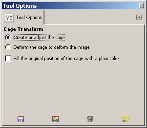

keshef wrote:
is there a way to toy with the cage, and only render at the end?
Doesn't switching to "Create or adjust the cage" in the Tool Options allow that?

1) i didn't know about tool-presets :-o
2) even after applying this file, i have only 3 options (for cage transformations)
(tested both for gimp 2.8.10 and 2.9 nightly build)
