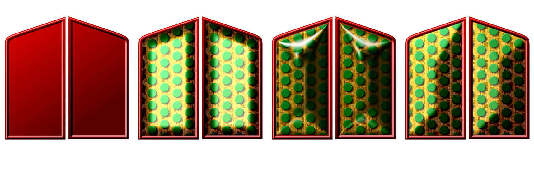

The examples below show how the different panels look when the same decorative layer is applied with Custom Font FaceMaker and then combined with the box file. (From left to right: the box file using a simple red gradient, the high gloss panel, the BRL hilite panel and the peak panel.)

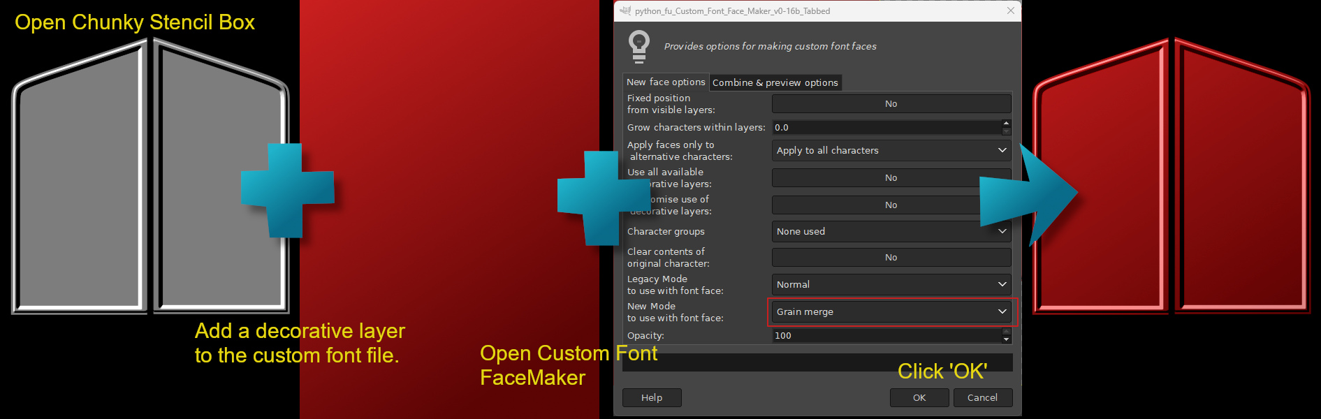

An example project workflow (you will need to have installed Custom Font FaceMaker in your user plug-ins folder):
Open Chunky Stencil Box in Gimp.
Add a new layer and fill it with a colour fill or paste an image into the file as a new layer.
Open the FaceMaker dialog:
Filters>>Custom Fonts>>Decorating Tools>>Custom Font FaceMaker v0.16b Tabbed…
Select the mode that you want to use (Grain merge usually works well) and click on ‘OK’ to apply the change to each of the character layers.
When the filter has finished save the file with a new name (you can do this later if you are going to continue with this project now).

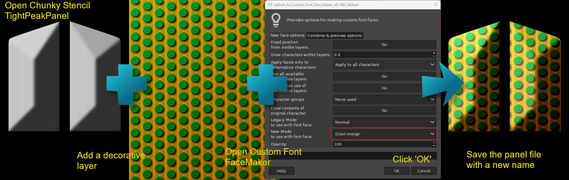

Open Chunky Stencil TightPeakPanel in Gimp.
Add a new layer and fill it with a colour fill or paste an image into the file as a new layer (you can also use one of the images included in the Other-Resources folder).
Select the mode that you want to use (Grain merge?) and click on ‘OK’ to apply the change to each of the character layers.
Save the new ‘panel’ file with a new name.

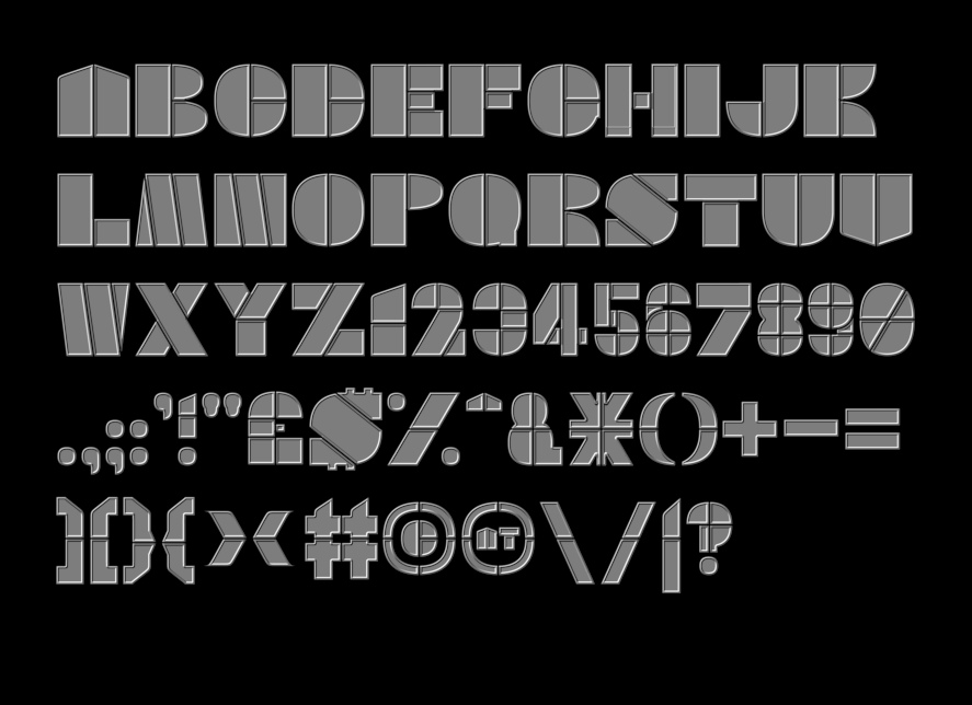

The image below shows examples of each of the base custom font files available; as before there are accented characters available to cut and paste into each style should you require them.
From the top: Box style, Tight Panel (to decorate as you wish), Peak Panel, Gloss Panel, BRL Hilite Panel, Hilite Panel.
