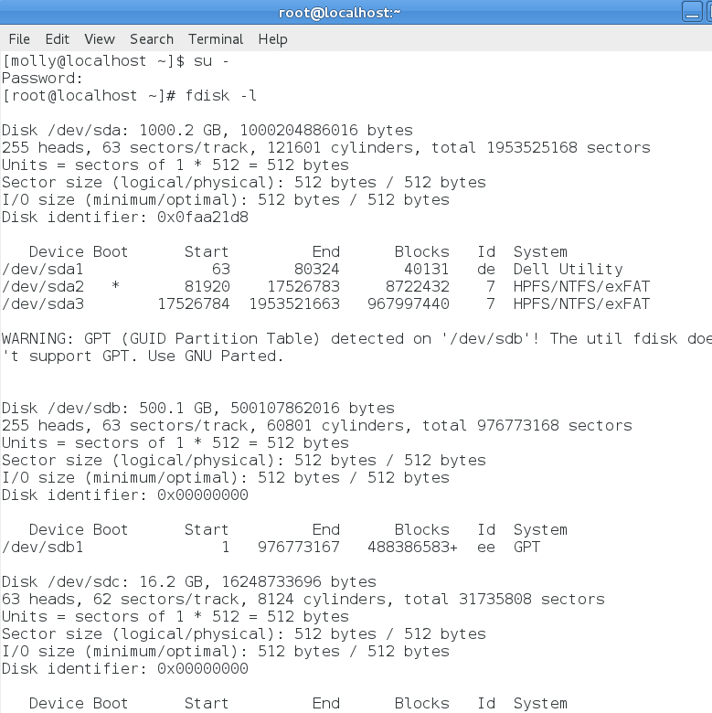

On mine I type su - to get to the (root@localhost) then on mine it asks for a root password but I don't know if you need that on a test one.
On the next line after [root@localhose -]# (type) fdisk -l

:ditto what Molly said. On the live CD, you first enter su and press the enter key to become root (no password required), then enter the fdisk -l command. Also, make sure you have the USB device you plan to install on connected to the system when you boot from the Live CD.

This is the info I hope will help to decide how to install my fedora
 Post subject: Re: Fedora 17 supposed to come out today at 10 EST
PostPosted: Sat Jun 02, 2012 7:03 pm  (#51)
Looks like you did not connect the USB device you plan to install Linux on. You need to do that before booting with the LiveCD.
Linux is seeing two physical hard drives and one mounted CD media.
Linux sees the first drive as sda with Windows NTFS (the disk size got clipped in your screenshot)
Linux sees the second drive (80g) as sdb with FAT32
Connect the USB device, boot up again with the Live CD and run the fdisk -l command again. Linux will most likely designate your USB device as sdc but you need to verify that.

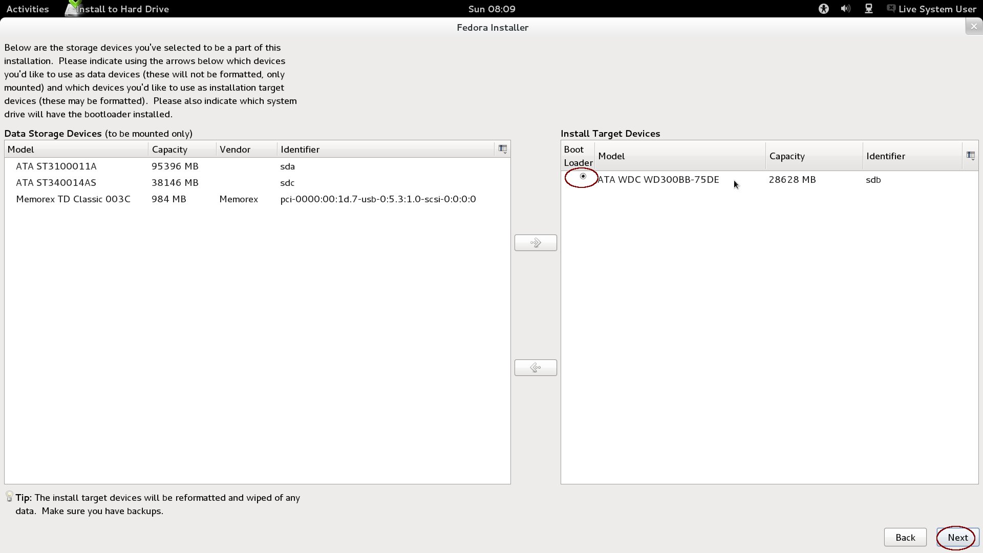

Sorry about not getting this up last night. It was late and I was sleepy. :otb
From this point on we will assume your external 80g USB drive is sdb and that will be the target of our Linux install. Boot Fedora 17 Live CD and verify that Linux is seeing your 80g USB drive as sdb. After confirming that, select Install to Hard Drive from the application list.
I've put together some screen-shots that should help with the installation.

Highlight your 80g USB drive on the left side list and click the right arrow to move it to the install list on the right.
Check the bootloader box beside the 80g USB drive (sdb) on the right side install list then click next.

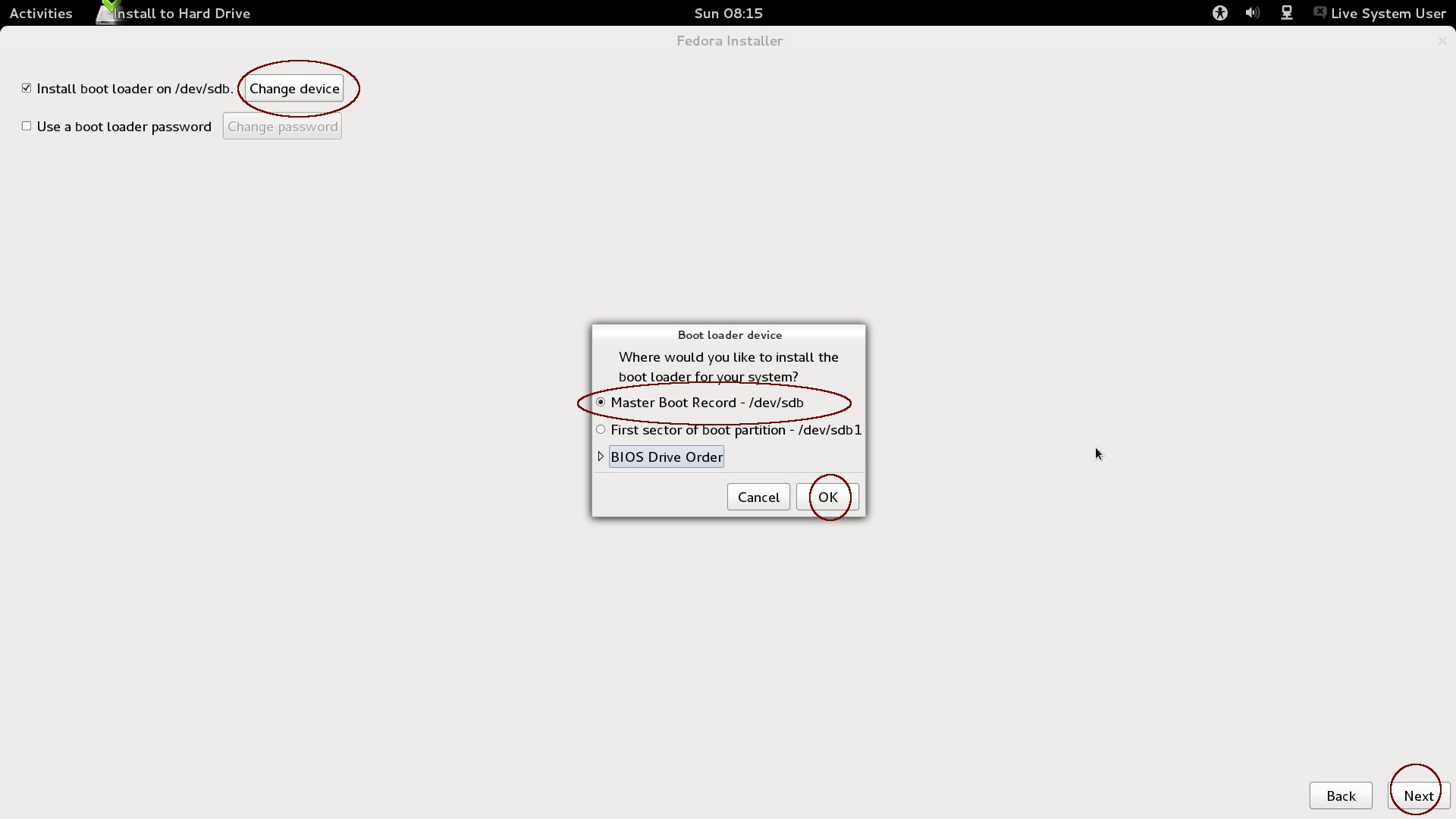

1) Select that the bootloader will be installed to your 80g USB drive /dev/sdb
2) Click "Change Device" to verify that the MRB will be used on your USB drive designated sdb
3) Click OK then next.
