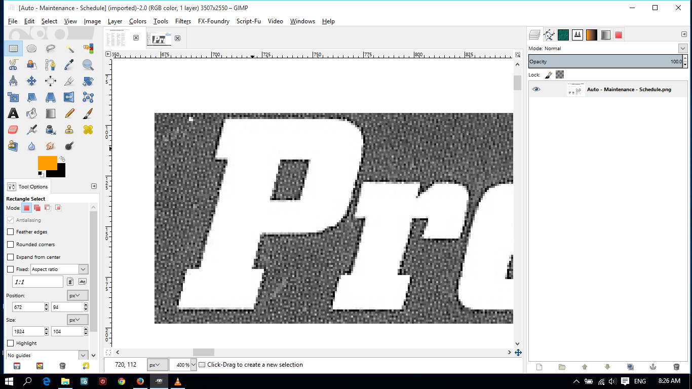

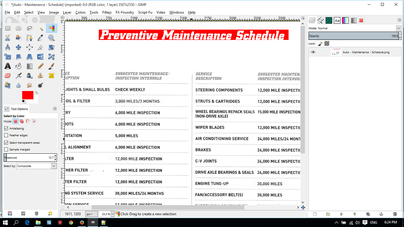

Open your image that you want to replace the background of header text in GIMP.
1. Use "Rectangle Select Tool" to Select the area to be replace color with. (On windows you can hold Ctrl key and scroll mouse button to zoom in or out, and adjust the rectangle to select an accurate rectangle)

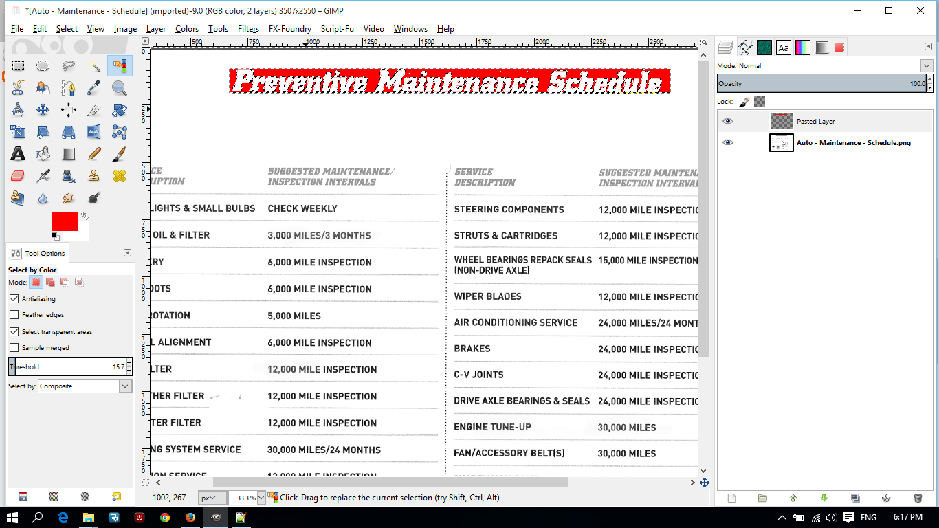

2. Ctrl-C to Copy (or menu item Edit/Copy). Ctrl-V to Paste (or menu item Edit/Paste Into). You'll have a Floating Selection on top of your original layer (like below).
3. Right click the Floating Selection and select "To New Layer". This will put your copied area into a new layer above the original background.
4. Use "Select By Color Tool" and click on the White part of the Header text to select all that white in that layer.
5. Ctrl-I to Invert Selection (or menu item Select/Invert). This will select anything that isn't the White previously selected in that layer.
6. Click on the Foreground Color to change it to any color you like to replace the grey/black header background with. (here i am just selecting red).
7. Click and drag the Foreground Color into your working area. This will cover the selected area with red.
8. It's done, now we just have to merge visible layers. Right click on any layer in the Layers Window, and select "Merge Visible Layers..." then click "Merge" when the window pops up.
9. menu item Select/None to see the image without the selection moving ants.
10. Now you can Export to save your new image.
PS: If you wanted to play with Text Tool, you can select the Big Capital A icon in Tools, then drag and select an area on your working area to add text to, and start typing away, and play around with text options.

This method creates pixellated text.... For good results, once copied to a new layer:
1) use Color-to-alpha to remove the background (or repaint the background in "Color erase" mode)
2) lock the alpha channel and bucket fill with the new color
3) if a background color is necessary, unlock alpha channel, set bucket-fill to "Behind" mode and bucket fill with required background color.

but i was wondering if this pixelized gray scale background stops me from performing those steps...
I could only get it to partially fill a color and not a pure color.

eagertolearn: you're getting lots of good tips here - all of them useful to know, but not all of them equally easy to apply on this particular image. for example, trandoductin's method is good if you're in a hurry and don't want to be too fussy about the result, but it does give pixellated text, just as ofnuts says. ofnut's method is in my opinion more elegant but not as easy to use for a beginner - colour to alpha removes the target colour wherever it shows up, so if you for example have a very pixellated white text with lots of grey spots in it and you have a grey background you want to remove, you will get lots of little holes in the white text where the grey spots used to be. if you make a red background that will look awful. i agree with wallace that a layer mask would be a good solution for this, at lest if the image is highly contrasted. the example image trandoductin posted would be ideal for this. you'd just add a layermask and in the dialogue box choose "greyscale copy of layer". then you could edit the layer mask using curves or brightness and contrast until you got rid of the background. that would give you a chance to change colour of just the text if you wanted. if you invert colours of the layer mask you will get just the background, and that in turn will give you a chance to change colours of just the background.
