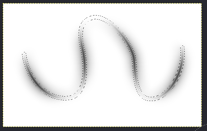

i am trying to do your 1st method manually and was confused about step 13.
after i do alpha to selection and deleted i am left with this.
is that right or did i miss something.
