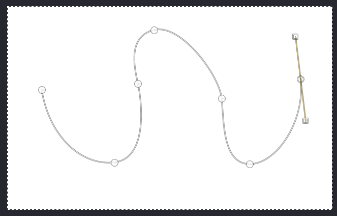

1. Here's the path that I want to turn into a sharp selection:

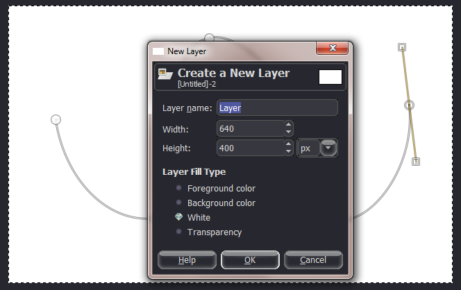

2. Create a new white layer:

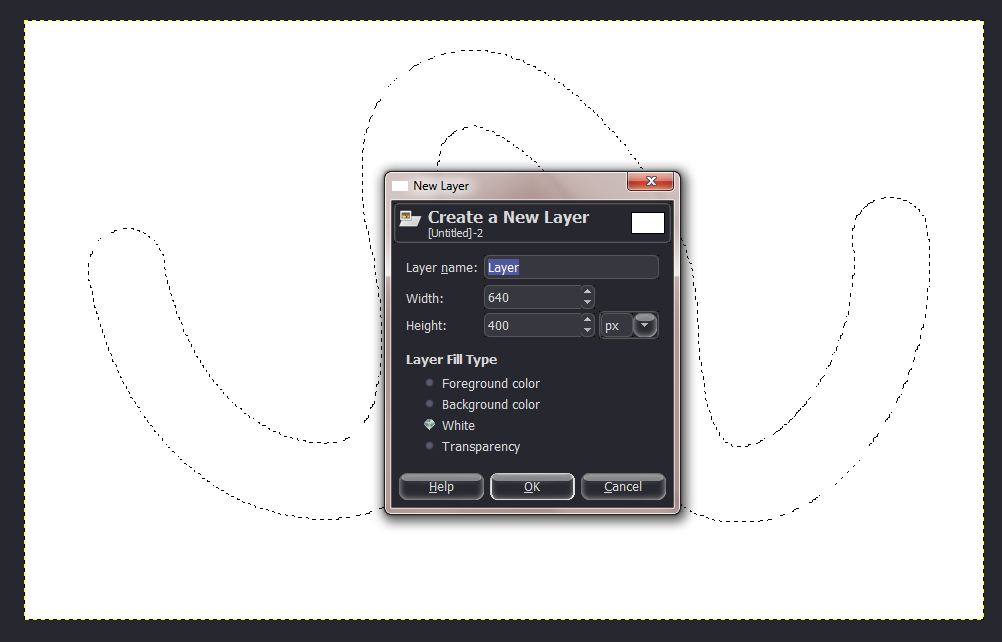

7. Delete the active layer and create a new white layer:

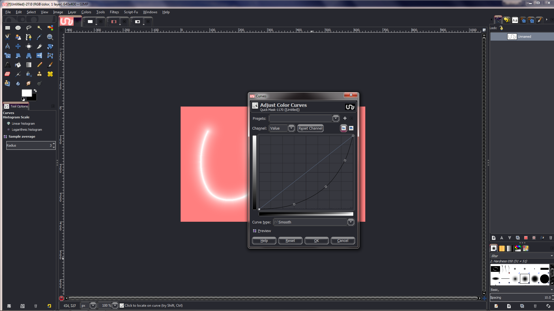

10. Do a Curves function with a saved preset curve like this one to make the color sharp to a point of black:

3. Then go back into quick mask mode and perform the curves function on it to make it sharp:
