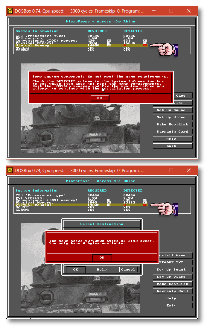

I was wondering if anyone had any experience using DosBox to run old dos games?
I'm trying to run this old game from 1995 that I have on disk,
but every time I set it up to run.
The game goes through a,
"Game Requirements Detection" and states it has detected that I have 0 (zero) Virtual Memory.
I've tried using the "Freesize" dos command to set the size of the VM for the drive,
but even after doing this it still detects zero virtual memory and I'm unable to install the game.
Here's a screenshot of the games splash screens.
Showing the virtual memory requirements and what's been detected.
Any suggestions?

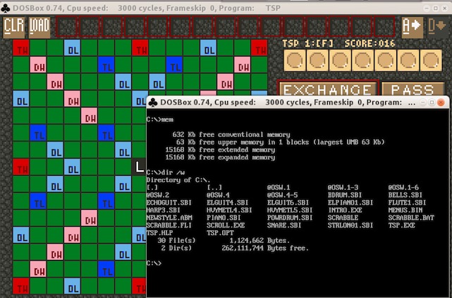

Only ever used dosbox for this old scrabble and then only in linux
For the memory I have a dosbox-0.74.conf file which contains the section.
[dos]
# xms: Enable XMS support.
# ems: Enable EMS support.
# umb: Enable UMB support.
# keyboardlayout: Language code of the keyboard layout (or none).
xms=true
ems=true
umb=true
That gives memory and file values as:
Zero disk space? Are you trying to run off a CD?
Have you mounted the game folder as per the very sparce dosbox help?
best of luck ;)

This is what I've managed to do thus far...
1. Added all the files from the CD, to a folder, mounting the C drive and folder as, C C:\folder name.
2. Run command "dir" for the "C: drive", showing the list of files within this drive.
3. Running the command, Install.exe from the c drive folder.
Doing this opened the game's splash screen.
Displaying a message that the game needed to be installed for the disk.
4. placed disk into cdrom drive and mounted the cdrom drive in dosbox.
The same results appear every time without exception, zero virtual memory.
I'm at a loss as to why the drive shows up with zero Virtual Memory, no mater how I run it?
Making the game uninstallable, due to lack of the required virtual memory needed to run the game.
