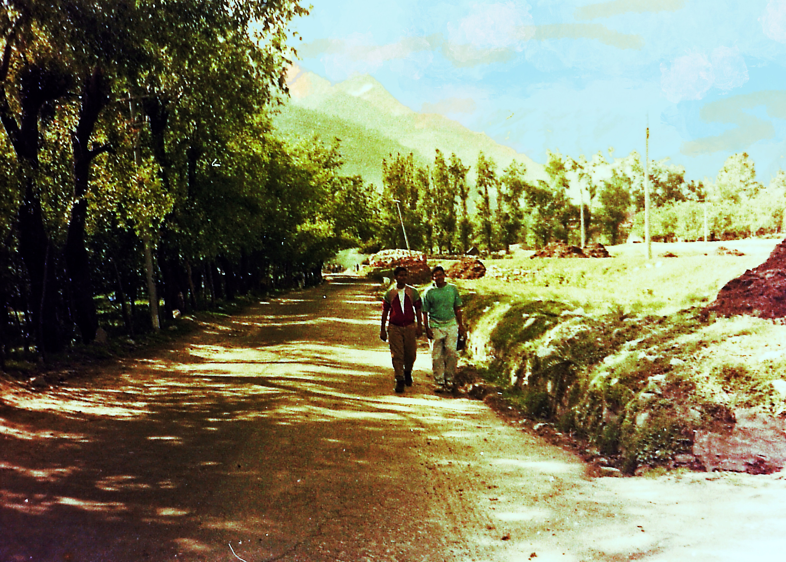

I have to convert around 200 pictures from negatives. Some of them are very precious, with my brother who was on the Indian Army and was killed fighting terrorists in 2000.
I have bought a negative scanner but the images are very yellow. I have tried the colour average method but does not seem to get it done. Any other way and is there a way to automate the process so I don't have to do it 200 times?
Original File
With the Average Layer method

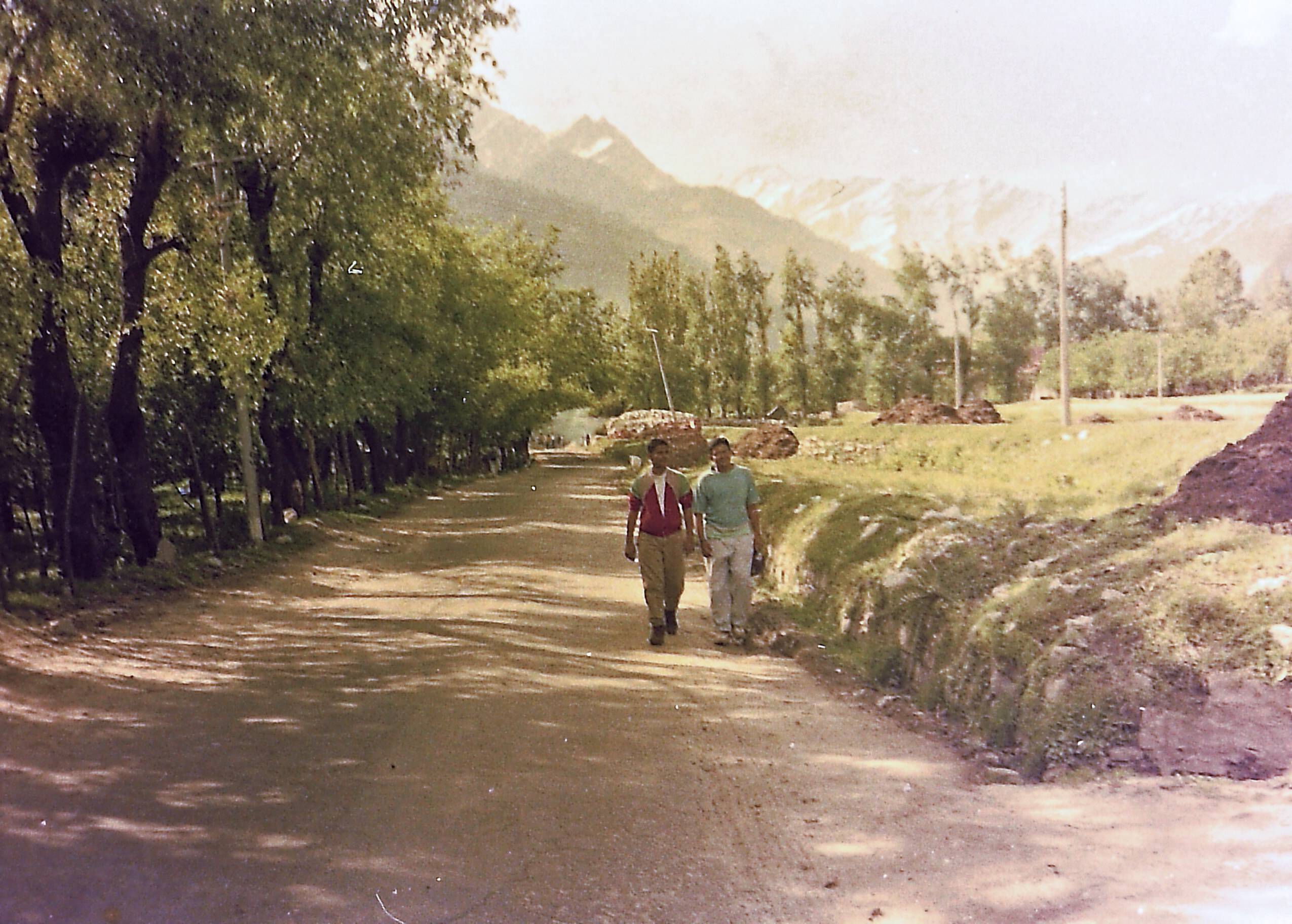

Here is a topic about "color cast":
viewtopic.php?f=18&t=14147
In this topic I forgot to mention the G'MIC>Colors>Mixer [...] filters, they are very useful too.
I recommend to instal G'MIC.
With 200 images, I would prefer to do process them one by one. You said the pictures were precious, so I would give them a special treatment. If you use G'MIC in GIMP, the sliders will stay in their position (in that session), so you can repeat those settings for other images.
The next example is not perfect (upper image is last edited, more red). But a nice begin. With repairing a strong color cast, you will always lose some colors. Here is a strong yellow color cast. When repairing, you will lose some of the original yellow in the image.
Here I used G'MIC>Colors>Specific saturation
G'MIC curves
GIMP color balance:

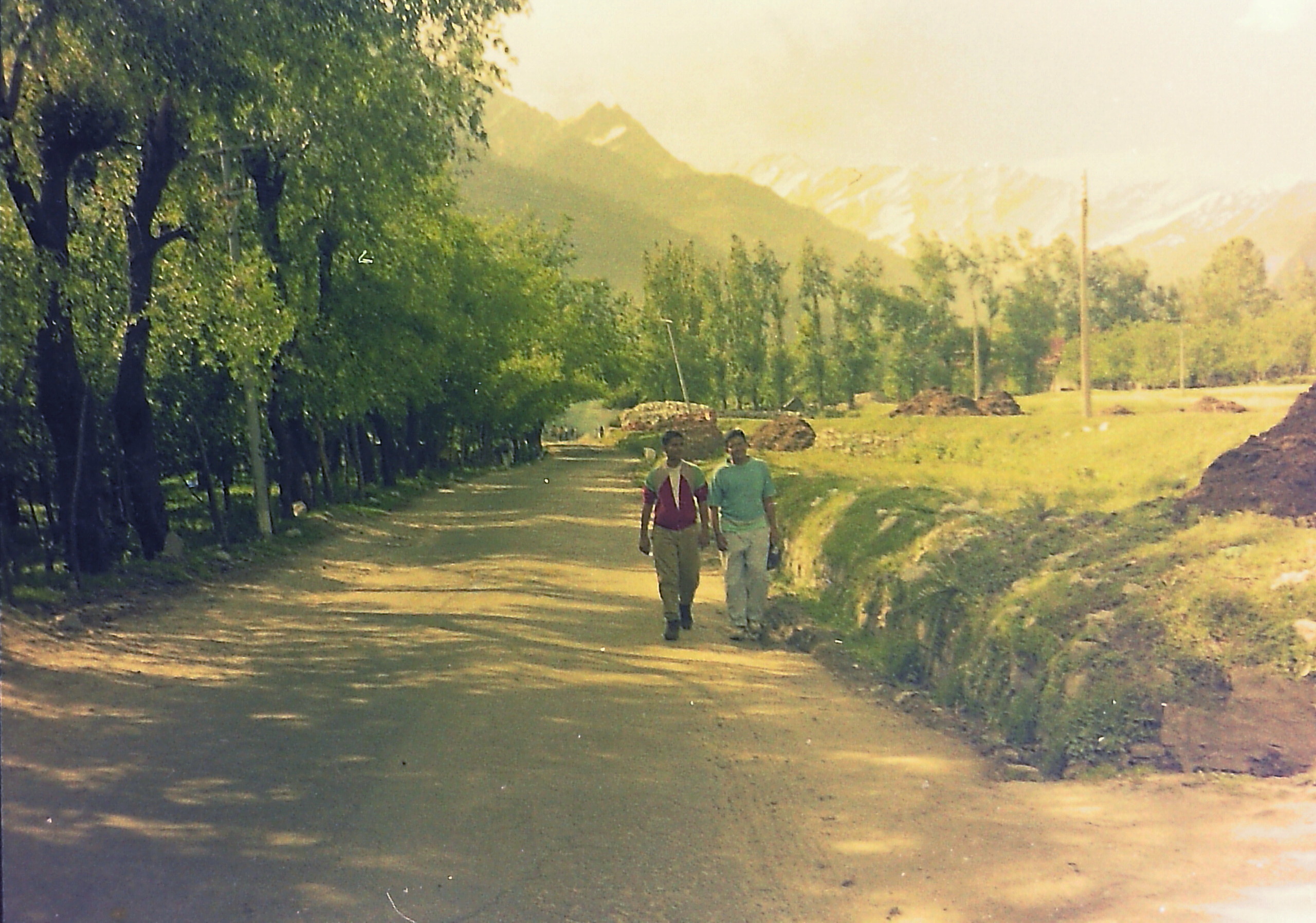

 Post subject: Re: Scanning Negatives
PostPosted: Sat Dec 17, 2016 3:44 pm  (#5)
Posts: 14263
Welcome Sonam, iarga did a very nice treatment on your image. I only applied the new filter Crazy Tone Map on her result.
Don't forget Sonam that iarga gave you a nice tip, when you apply any action in Gimp, the programme keeps the last filter/script used for your next photos to mend. It is under Filters at the first upper option.

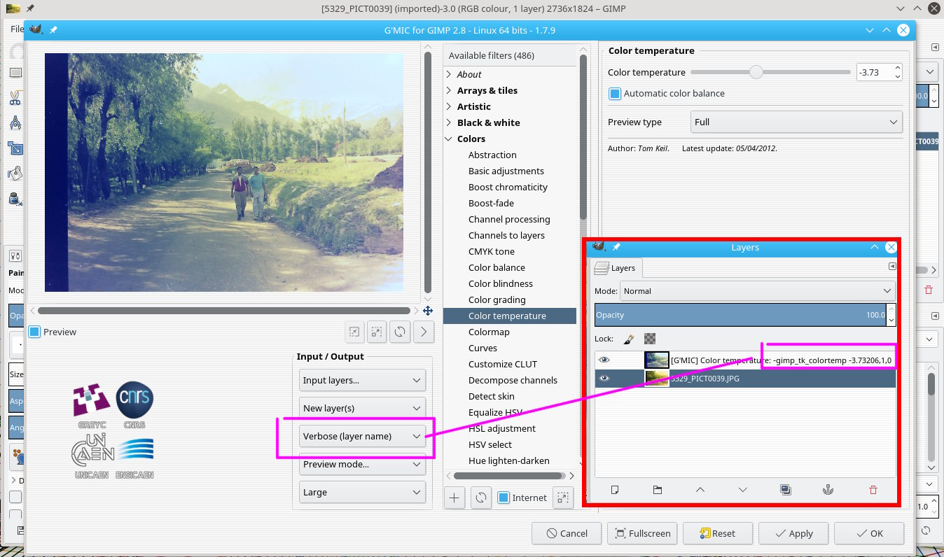

Using Gimp the plugins gmic and BIMP
http://www.gmic.eu and http://www.alessandrofrancesconi.it/projects/bimp/
Find a suitable gmic filter and determine the settings. This one is short, and can be copied from the layer name, others might need the gmic logfile if they are long.
In this case I get:
-gimp_tk_colortemp -3.73206,1,0
In BIMP, enter that as 'other Gimp procedure' with values '1' and the above string. Add the folder of files and an output folder.
best of luck.

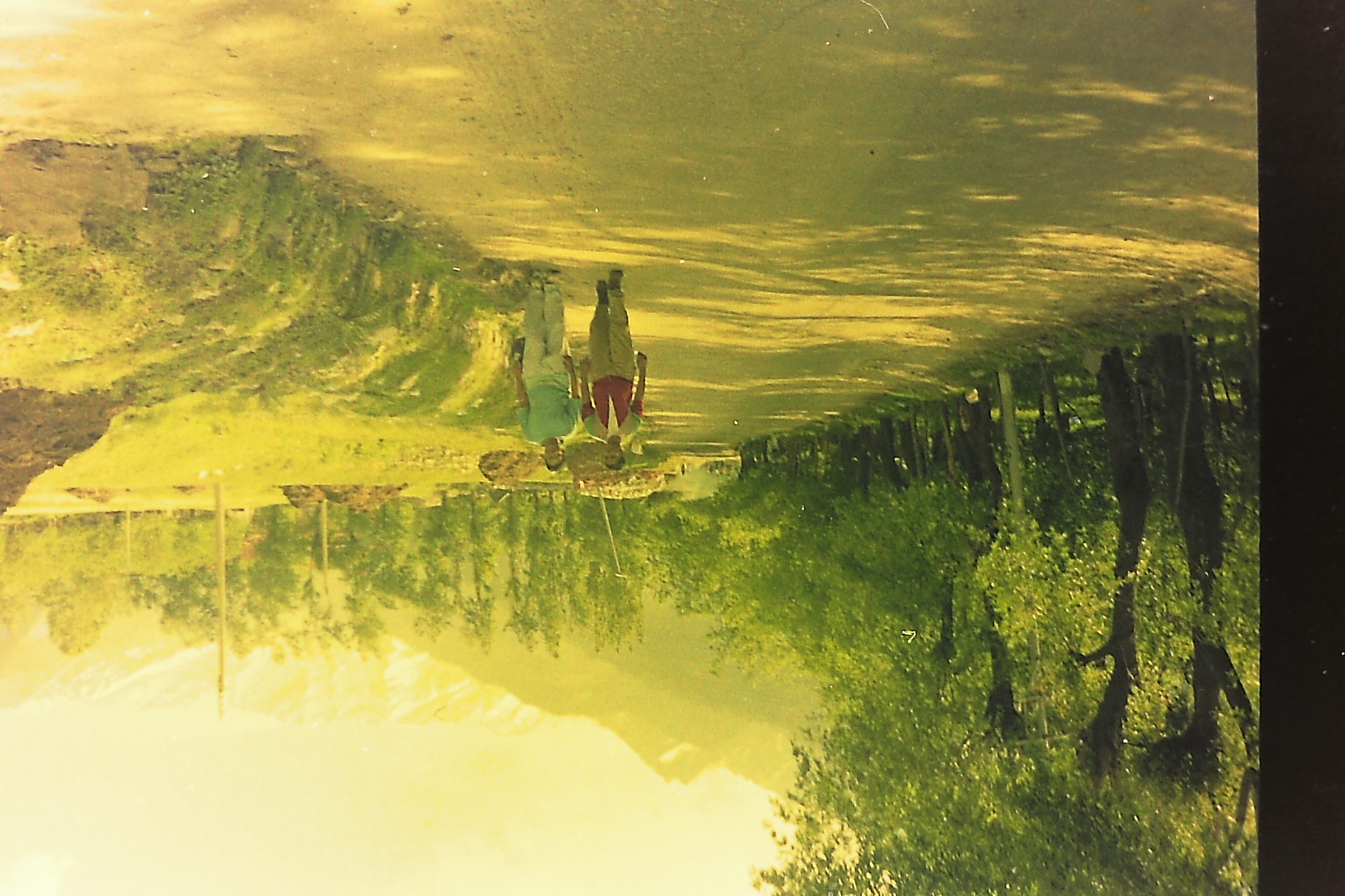

New outcome, obtained using Gimp functions/filters.

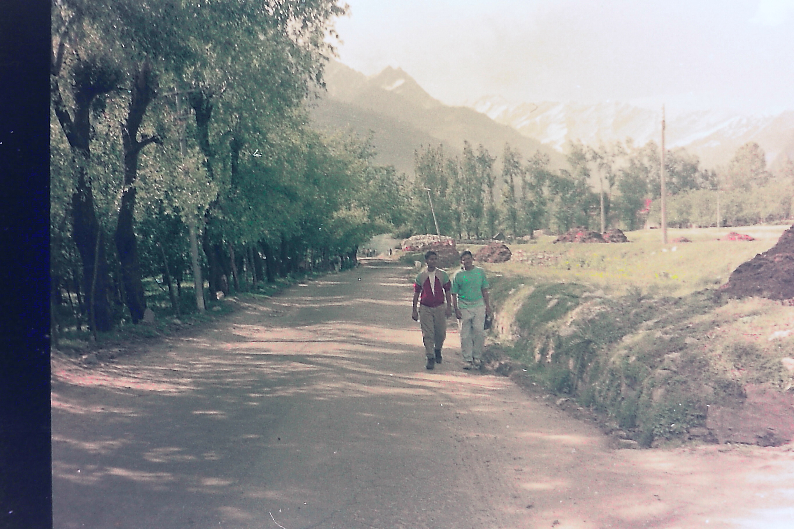

Unfortunately your 'sky' is blown out. This is the best I could do with it.
Oh forgot to mention
That was just using hue/saturation on the yellow
Contrast to embolden what was there then I enhanced the colour to brighten the green.
