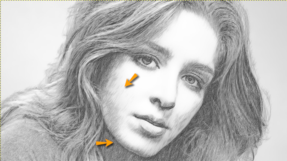

I found the original image to do this, but I having trouble.
No matter what I do, it not the same, I've tried 5 times, can anyone explain.
I have the latest GIMP 3.2.6 and the latest G'MIC-QT and set the output to "new layers",
tried the PDF file instructions. Read the whole thread, everything seems to be confusing. Also
tried different desaturation settings and nothing seem to work, even tried color to gray. My
problem is the cheek area is missing or doesn't look the same, not even close to what it should
look like, and under the chin is off, it just blends together. This is what it should look like when
you're done but can't get the same result.
Can anybody do a shorthand step by step, it says "To desaturate it (mode: luminosity)"
That option isn't in the latest gimp, unless it's been renamed to "Luma."

Gimp 2.10 changed Gaussian blur. Given this tutorial precedes that you can approximate the old value by multiplying by 0.32. So the tutorial saying Gaussian Blur 33 is now approximately 33 * 0.32 ≈ 10.56 if you are using gimp 2.10 or later.

Also as this is tutorial could be made for GIMP 2.8 use legacy layer modes in modern GIMPs.

Was not able to recreate this sketch has shown in the end.
Creating the copy visible paste layer to grayscale is not possible with GIMP 3.2.6.
Unless you start using other filters to match his step. The other problem in decoding this is,
that the Hard sketch in G'MIC - QT has 3 different effects for the same settings, just by
hitting the enter key. Then there's the blending modes, they don't work as describe, even
though I figure out a different set of setting and opacity to match his effect.
This is to bad. It is lost.
Why not?
My try with this tutorial:
Sorry can't show. When I want to upload it says:
The upload was rejected because the uploaded file was identified as a possible attack vector.
Get that trial image from my pcloud then:
https://e.pcloud.link/publink/show?code ... YdHRd7ghlk
I think it came out fine ....
