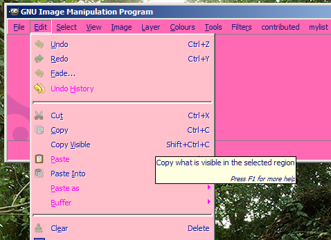

Hallo abraess,
I'm not sure I understand what you are saying.
Your screenshot shows the menu background (bg[NORMAL]) is "pink" and the foreground (fg[NORMAL]) is magenta.
The item that is showing the tool-tip, Sichtbares kopieren, in English "Copy Visible", is currently disabled and it's colour is being set by the fg[INSENSITIVE] colour from the gimp-default-style, which on my gtkrc is set to "lighter (@fg_color)":
You can add a fg[INSENSITIVE] to the "menu" style to change it: eg:
  fg[NORMAL] = "magenta"
  fg[PRELIGHT] = "darkblue"
  fg[INSENSITIVE] = "green"
  bg[NORMAL] = "pink"
  bg[PRELIGHT] = "black"
Kevin

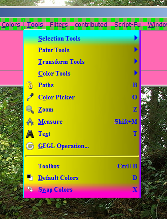

While we're on the subject of styling the menus/menubar, I'll show you how to apply a background image like the ones Mikechat is so keen to show us.
There are a couple of ways to do this.
You can add a bg_pixmap[NORMAL] entry to your style:
style "menu" = "gimp-default-style"
  fg[NORMAL] = "blue"
  fg[PRELIGHT] = "#FF0000"
  bg[NORMAL] = "yellow"
  bg[PRELIGHT] = "green"
  xthickness = 1
  ythickness = 4
  bg_pixmap[NORMAL] = "bg.png"
This will tile the background image onto your menu. If the image is bigger than the menu, you will only get the part of the image that fits. Note that this can be applied to any style, including the gimp-default-style.
The alternative method allows some more control:
  fg[NORMAL] = "blue"
  xthickness = 1
  ythickness = 4
  engine "pixmap"
      function      = BOX
      detail      = "menu"
      file      = "/menus/menu_bg.png"          # image for the background of drop-down menus
      border      = { 0, 0, 0, 0}
      stretch      = FALSE
Here we are using the "pixmap" rendering engine to apply the image. The control we have is to specify if the image should be tiled or distorted to fit the available space as demonstrated by Mikechat's examples.
Setting the stretch parameter to FALSE means the image will be tiled. TRUE means it will be distorted to fit.
In addition we have the border parameter. This specifies how much of the edges must not be stretched, in the order Left, Right, Top, Bottom. This is best illustrated with an example:

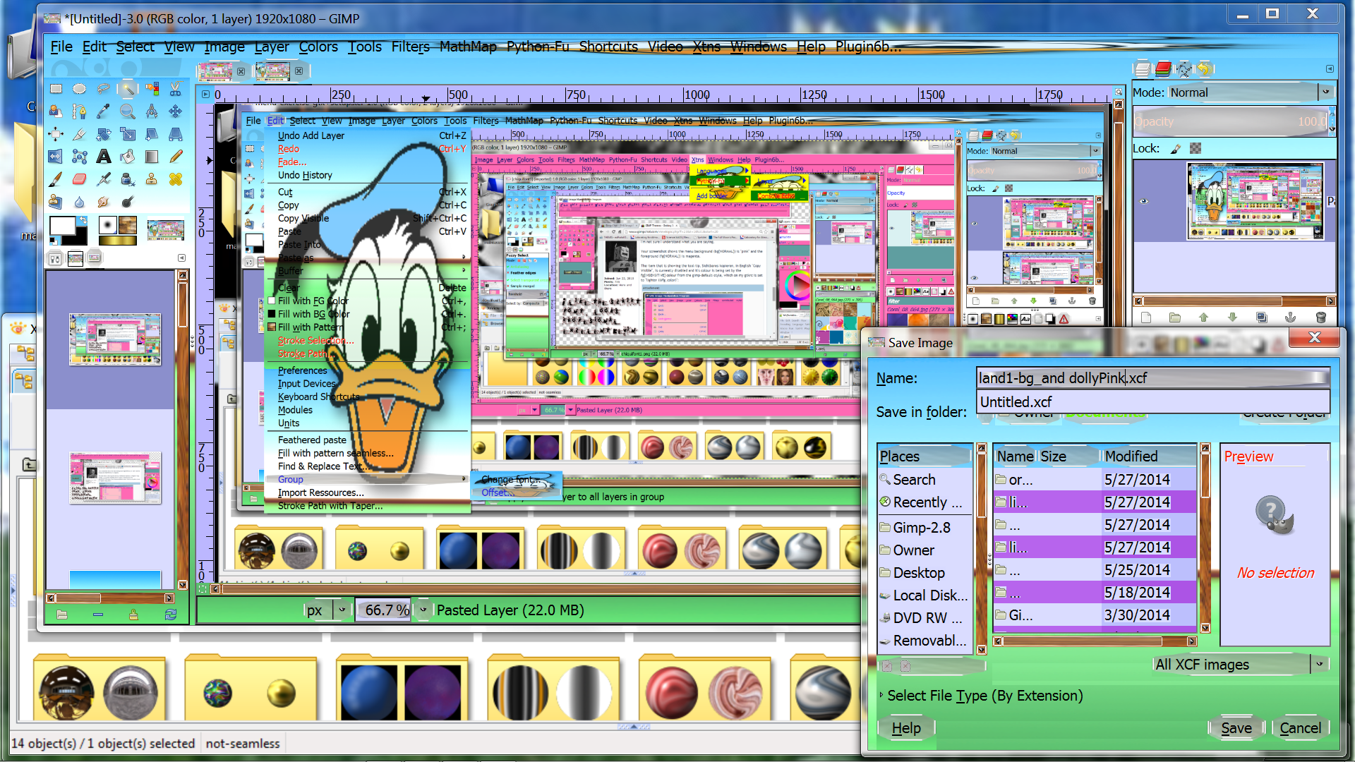

Here I have used a partly transparent image (see menu_bg.png attached) with 1 pixel borders
and have specified the border parameter as {1, 0, 0, 0} so 1 pixel of the left edge is not stretched but the other borders are.
I have used a partly transparent image for the background to show how the background colour shows through, which is a way of making the theme common across the widgets without having to edit all the images for each widget when you change the colours.

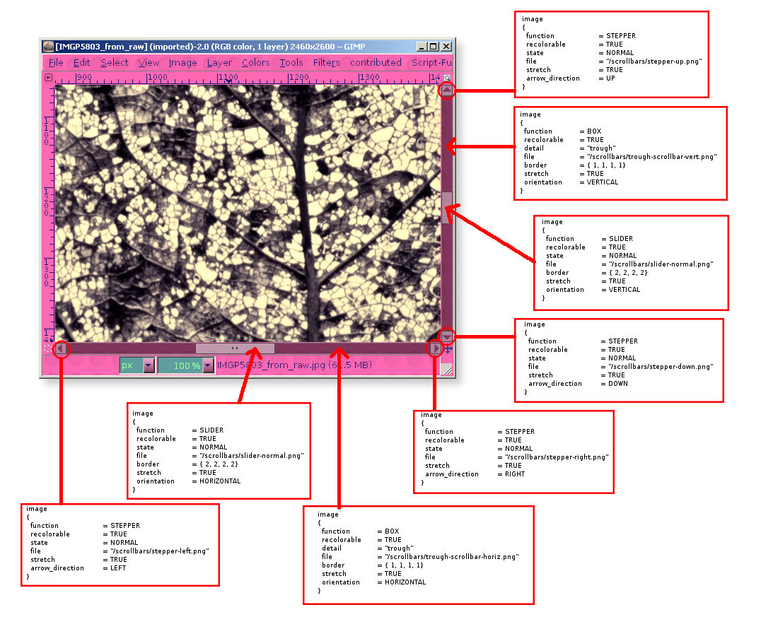

Scrollbars
These are made from several elements, each of which can be styled and have can have different images for each of the standard states.
Here is a image to point out the various elements:
And the associated code in rc_scrollbars.rc is this:
style "scrollbars" = "gimp-default-style" # For scrollbars - for example the Image window scrollbars

      stretch      = TRUE
      orientation   = HORIZONTAL
      function      = BOX
      recolorable   = TRUE
      detail      = "trough"
      file         = "/scrollbars/trough-scrollbar-vert.png"
      border      = { 1, 1, 1, 1}
      stretch      = TRUE
      orientation   = VERTICAL
      function      = SLIDER
      recolorable   = TRUE
      state         = NORMAL
      file         = "/scrollbars/slider-normal.png"
      border      = { 2, 2, 2, 2}
      stretch      = TRUE
      function      = SLIDER
      recolorable   = TRUE
      state         = PRELIGHT
      file         = "/scrollbars/slider-prelight.png"
      stretch      = TRUE
      overlay_file      = "/scrollbars/slider-horiz-over.png"
      overlay_border   = { 2, 2, 2, 2}
      overlay_stretch   = FALSE
      function      = SLIDER
      recolorable   = TRUE
      state         = ACTIVE
      stretch      = TRUE
      function      = SLIDER
      recolorable   = TRUE
      state         = INSENSITIVE
      file         = "/scrollbars/slider-insensitive.png"
      stretch      = TRUE
      function      = SLIDER
      recolorable   = TRUE
      state         = NORMAL
      stretch      = TRUE
      function      = SLIDER
      recolorable   = TRUE
      state         = PRELIGHT
      stretch      = TRUE
      overlay_file      = "/scrollbars/slider-vert-over.png"
      function      = SLIDER
      recolorable   = TRUE
      state         = ACTIVE
      stretch      = TRUE
      function      = SLIDER
      recolorable   = TRUE
      state         = INSENSITIVE
      stretch      = TRUE
      function         = STEPPER
      recolorable      = TRUE
      state            = NORMAL
      file            = "/scrollbars/stepper-up.png"
      stretch         = TRUE
      arrow_direction   = UP
      function         = STEPPER
      recolorable      = TRUE
      state            = PRELIGHT
      file            = "/scrollbars/stepper-up-prelight.png"
      stretch         = TRUE
      function         = STEPPER
      recolorable      = TRUE
      state            = ACTIVE
      stretch         = TRUE
      function         = STEPPER
      recolorable      = TRUE
      state            = INSENSITIVE
      file            = "/scrollbars/stepper-up-insensitive.png"
      stretch         = TRUE
      function         = STEPPER
      recolorable      = TRUE
      state            = NORMAL
      file            = "/scrollbars/stepper-down.png"
      stretch         = TRUE
      arrow_direction   = DOWN
      function         = STEPPER
      recolorable      = TRUE
      state            = PRELIGHT
      file            = "/scrollbars/stepper-down-prelight.png"
      stretch         = TRUE
      function         = STEPPER
      recolorable      = TRUE
      state            = ACTIVE
      stretch         = TRUE
      function         = STEPPER
      recolorable      = TRUE
      state            = INSENSITIVE
      file            = "/scrollbars/stepper-down-insensitive.png"
      stretch         = TRUE
      function         = STEPPER
      recolorable      = TRUE
      state            = NORMAL
      file            = "/scrollbars/stepper-left.png"
      stretch         = TRUE
      arrow_direction   = LEFT
      function         = STEPPER
      recolorable      = TRUE
      state            = PRELIGHT
      file            = "/scrollbars/stepper-left-prelight.png"
      stretch         = TRUE
      function         = STEPPER
      recolorable      = TRUE
      state            = ACTIVE
      stretch         = TRUE
      function         = STEPPER
      recolorable      = TRUE
      state            = INSENSITIVE
      stretch         = TRUE
      function         = STEPPER
      recolorable      = TRUE
      state            = NORMAL
      file            = "/scrollbars/stepper-right.png"
      stretch         = TRUE
      arrow_direction   = RIGHT
      function         = STEPPER
      recolorable      = TRUE
      state            = PRELIGHT
      file            = "/scrollbars/stepper-right-prelight.png"
      stretch         = TRUE
      function         = STEPPER
      recolorable      = TRUE
      state            = ACTIVE
      stretch         = TRUE
      function         = STEPPER
      recolorable      = TRUE
      state            = INSENSITIVE
      file            = "/scrollbars/stepper-right-insensitive.png"
      stretch         = TRUE
In addtion to the images, some other properties can be specified. For example:
GtkScrollbar::min-slider-length   = 30
At this point it's worth pointing out the GTK documentation, in this case for GtkScrollbar: https://developer.gnome.org/gtk2/2.24/GtkScrollbar.html which lists the style properties specific to this widget.
It should also be noted that it inherits style properties from it's parent widget GtkRange: https://developer.gnome.org/gtk2/2.24/GtkRange.html so you can also specify those properties for the scrollbars:
GtkScrollbar::slider-width = 50
Kevin

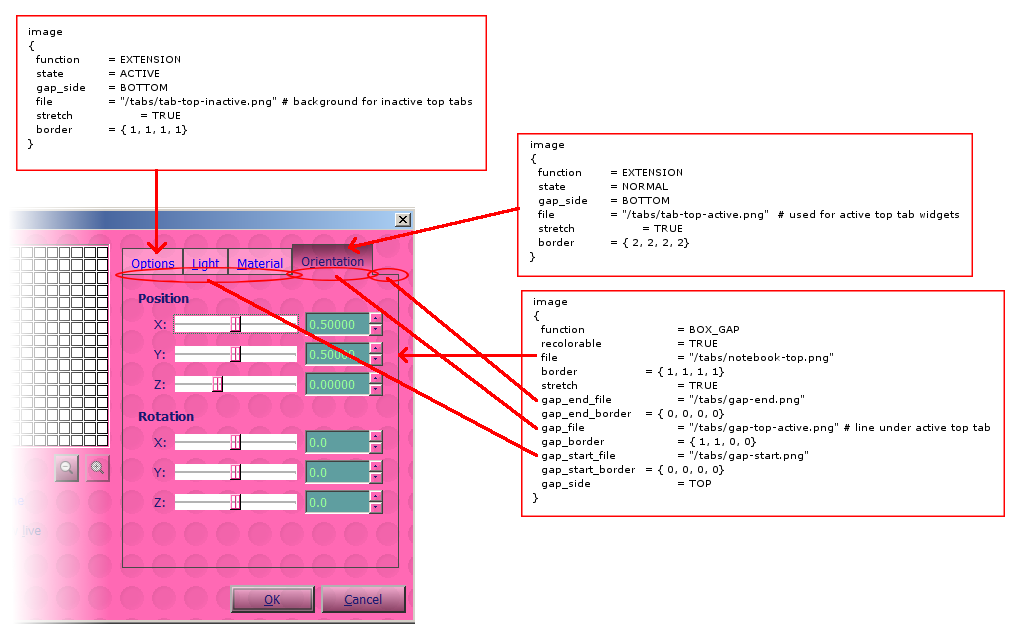

Today it's tabs:
In the GTK world - tabbed widgets are known as Notebooks
They are used in GIMP for the docked windows in the toolbox:
But here I'm using the Filters>>Map>>Map Object dialog as it's slightly clearer:
The associated code in rc_tabs.rc:
# https://developer.gnome.org/gtk2/2.24/GtkNotebook.html
style "tabs" = "gimp-default-style"
  xthickness = 4
  ythickness = 4
  GtkNotebook::tab-curvature = 2  # sets horizonal padding internal to the tab
  GtkNotebook::tab-overlap = 0    # sets how much the tabs overlap
  engine "pixmap"
      function   = EXTENSION
      state      = NORMAL
      gap_side   = BOTTOM
      file      = "/tabs/tab-top-active.png"  # used for active top tab widgets for examaple in "Map to Object"
      stretch   = TRUE
      state      = ACTIVE
      gap_side   = BOTTOM
      file      = "/tabs/tab-top-inactive.png" # background for inactive top tabs
      stretch   = TRUE
      function         = BOX_GAP
      recolorable      = TRUE
      file            = "/tabs/notebook-top.png" # background for area containing tab page
      stretch         = TRUE
      gap_file         = "/tabs/gap-top-active.png" # line under active top tab
      gap_border        = { 1, 1, 0, 0}
      gap_start_file   = "/tabs/gap-start.png" # This is the top line of the paged area to the left of the active top tab
      gap_start_border   = { 0, 0, 0, 0}
      gap_end_file      = "/tabs/gap-end.png" # This is the top line of the paged area to the right of the active top tab
      gap_end_border   = { 0, 0, 0, 0}
      gap_side         = TOP
  # the bottom, left and right tab orientations aren't used in GIMP
      state      = NORMAL
      gap_side   = TOP
      file      = "/tabs/tab-bottom-active.png" # used for active bottom tab widgets
      stretch   = TRUE
      state      = ACTIVE
      gap_side   = TOP
      file      = "/tabs/tab-bottom-inactive.png" # background for inactive bottom tabs
      stretch   = TRUE
      function         = BOX_GAP
      recolorable      = TRUE
      file            = "/tabs/notebook-bottom.png"
      stretch         = TRUE
      gap_file         = "/tabs/gap-bottom-active.png" # line on top of active bottom tab
      gap_side         = BOTTOM
      state      = NORMAL
      gap_side   = LEFT
      file      = "/tabs/tab-right-active.png"
      stretch   = TRUE
      state      = ACTIVE
      gap_side   = LEFT
      file      = "/tabs/tab-right-inactive.png"
      stretch   = TRUE
      function         = BOX_GAP
      recolorable      = TRUE
      file            = "/tabs/notebook-right.png"
      stretch         = TRUE
      gap_file         = "/tabs/gap-right-active.png"
      gap_side         = RIGHT
      state      = NORMAL
      gap_side   = RIGHT
      file      = "/tabs/tab-left-active.png"
      stretch   = TRUE
      state      = ACTIVE
      gap_side   = RIGHT
      file      = "/tabs/tab-left-inactive.png"
      stretch   = TRUE
      function         = BOX_GAP
      recolorable      = TRUE
      file            = "/tabs/notebook-left.png"
      stretch         = TRUE
      gap_file         = "/tabs/gap-left-active.png"
      gap_side         = LEFT
As far as I can see, only the top tab orientation is used in GIMP.
The GtkNotebook::tab-overlap = 0 controls how much the tabs overlap, and negative values will space them further apart.
Kevin
p.s. Because I learned some things preparing this I made some changes to the files, so I have attached the latest version.

Thanks for this great tutorial! It got me started when I was about to give up.
I've been trying for the last two days to make my own theme, as I want to move from Photoshop to Gimp. I've come really far (I think) and have now reversed engineered a lot of code, although I have no clue how to read it. And made a lot of icons.
Now I'm stuck and can't change the look of the tool percentage sliders, as I can't find any examples on how to add images/colors/size/border etc to them.
If you could give me a hint I would be really grateful.
The problem with the GIMP 2.8 sliders is that they are a custom widget rather than a standard GTK widget. This will mean you will have to look in the source code to find out how they are made and there's no certainty that they are styleable at all (although the colours can be set)
I also notice while watching GIT commits go past that there will be a new rotation adjustment widget in 2.10, which will probably not be styleable either (other than colours ?)
Kevin

I've done some experimenting and found that the sliders are GimpSpinScale widgets and I can do this to them:
using this code:
style "scale" = "gimp-default-style"
  fg[SELECTED]      = "white" # colour of label text when on top of the bar
  text[NORMAL]      = "red"   # colour of text when not on top of the bar - and the border???
  base[NORMAL]      = "cyan"  # background colour
  bg[SELECTED]       = "yellow"   # colour of bar when it's less than the minimum
  engine "pixmap"
      function   = BOX
      file      = "/scale/scale_bg.png"
      border      = { 0, 1, 0, 0}
      stretch      = TRUE
and the scale_bg.png image is this:
scale_bg.png [ 159 Bytes | Viewed 10416 times ]
I apply that style using this:
class "GimpSpinScale"             style "scale"
What I don't understand is why it stops drawing the bar using the image file when the bar is less than about 45 pixels wide. I'm going to try asking the developers: https://mail.gnome.org/archives/gimp-de ... 00074.html
Kevin
Kevin
Edit: It appears that the sliders (AKA scale widgets) are slightly styleable, but I've not worked out the details yet:
Thanks! The words "scale widgets" was the hint I needed.
