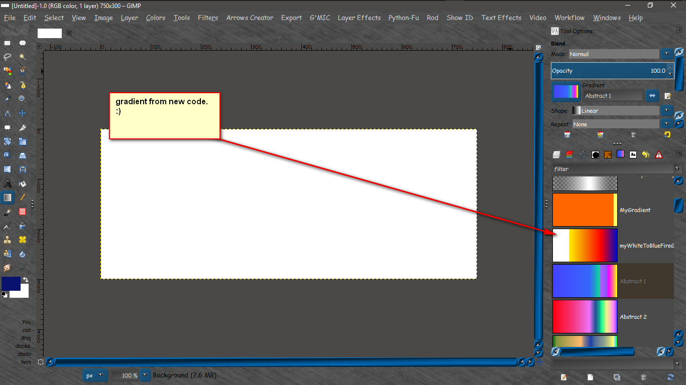

Figured it out.
The gradient syntax is different now.
    <defs>
      <linearGradient id="MyGradient">
        <stop offset="5%" stop-color="#F60" />
        <stop offset="95%" stop-color="#FF6" />
      </linearGradient>
    </defs>
So This
<defs>
<linearGradient id="myWhiteToBlueFireGrad" x1="0%" y1="0%" x2="100%" y2="0%">
<stop offset="0%" style="stop-color:rgb(255,255,255);
stop-opacity:1"/>
<stop offset="25%" style="stop-color:rgb(255,240,0);
stop-opacity:1"/>
<stop offset="50%" style="stop-color:rgb(245,125,0);
stop-opacity:1"/>
<stop offset="75%" style="stop-color:rgb(255,0,0);
stop-opacity:1"/>
<stop offset="100%" style="stop-color:rgb(0,10,195);
stop-opacity:1"/>
</linearGradient>
</defs>
Reverts to this
<defs>
<linearGradient id="myWhiteToBlueFireGrad">
<stop offset="5%" stop-color="#FFFFFF" />
<stop offset="25%" stop-color="#fff000" />
<stop offset="50%" stop-color="#f57d00" />
<stop offset="75%" stop-color="#ff0000" />
<stop offset="100%" stop-color="#000ac3" />
</linearGradient>
</defs>
Much simpler code also. :) :bigthup

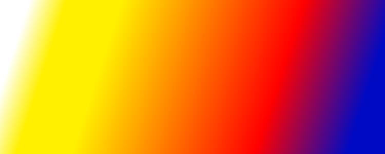

But i found that the white is really sharp using those percentages so i went with this instead.

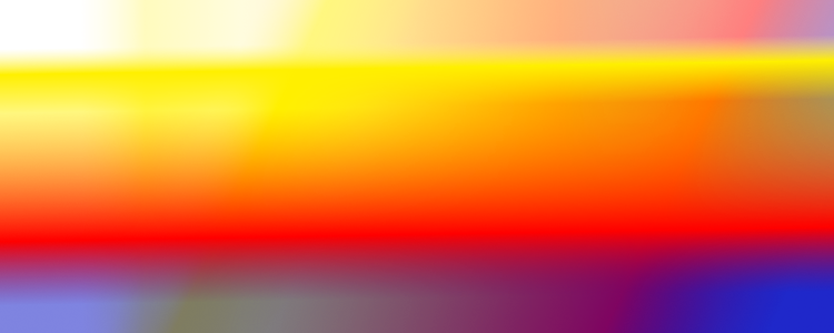

<defs>
<stop offset="0%" stop-color="#ffffff" />
<stop offset="10%" stop-color="#fff000" />
</linearGradient>
</defs>
Results

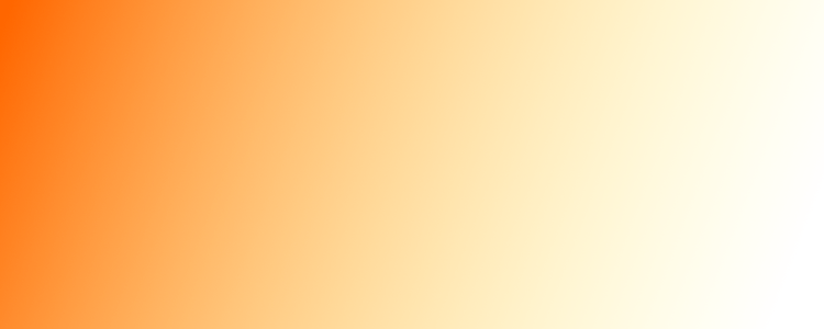

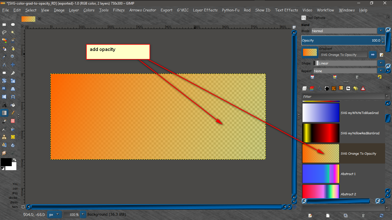

And an orange to opacity % SVG gradient.
    <defs>
      <linearGradient id="SVG Orange To Opacity">
        <stop offset="0%" stop-color="#F60" />
        <stop offset="100%" stop-color="#FF6" stop-opacity="0.50" />
      </linearGradient>
    </defs>
Results
And for full transparency on one side.
    <defs>
        <stop offset="100%" stop-color="#FF6" stop-opacity="0.0" />
      </linearGradient>
    </defs>

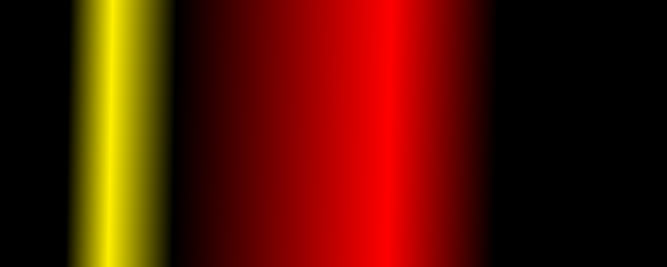

Experiment with the adding of points and opacities within those points. You can get bars by using this one.
<defs>
<linearGradient id="SVG myYellowRedBarGrad">
<stop offset="0%" stop-color="#ffffff stop-opacity=50" />
<stop offset="25%" stop-color="#fff000 stop-opacity=50" />
<stop offset="100%" stop-color="#000ac3 stop-opacity=50" />
</linearGradient>
</defs>
Results
 Post subject: Re: Creating svg gradients for Gimp
PostPosted: Tue Sep 20, 2016 11:54 am  (#35)
Posts: 16139
This one adds actual transparent areas between colors.
<defs>
<stop offset="0%" stop-color="#ffffff" stop-opacity="0.50" />
<stop offset="25%" stop-color="#fff000" stop-opacity="0.50" />
<stop offset="100%" stop-color="#000ac3" stop-opacity="0.50" />
</linearGradient>
</defs>
Results
