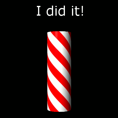

I had that happen at one time doing that and I don't know how I fixed it. I think I might have deleted it all and started from scratch. I don't know. ccbarr isn't on line very much but I know he could help you fix it but I would just start it over and maybe you might have missed one little step.
 Post subject: Re: GAP - Spinning Striped Pole
PostPosted: Sun Mar 03, 2013 6:38 pm  (#32)
no, don't do that, it has to be exactly like ccbarr wrote.
PostPosted: Sun Mar 03, 2013 6:47 pm  (#33)
Either delete it and start over or try posting your xcf in the attachment thing below. Maybe someone can figure out what caused the squares
PostPosted: Mon Mar 04, 2013 12:36 am  (#34)
You did it but you forgot to combine your background with the other layers
(filters/Animation/Combine background) and then delete your original background layer, and then when saving as gif set all layers 100ms then set disposal to replace for all layers
Just save the image below↓and open the gif in gimp and you will see what I mean
