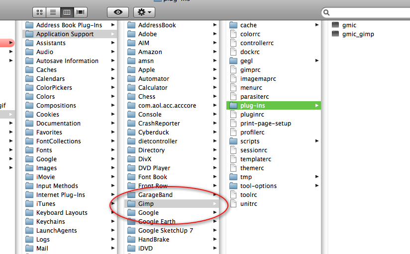

Do you mean delete the folder I have circled below?

PostPosted: Tue May 31, 2011 2:36 pm  (#45)
yes
 Post subject: Re: Adding G'MIC to Mac OS X 10.6.7
PostPosted: Tue May 31, 2011 2:37 pm  (#46)
Is this the one under Users/homefolder/library/applicationsupport/Gimp? If so, then yes, delete this folder. If GIMP is installed correctly, when you reboot GIMP, it will recreate all the folders automatically.
PostPosted: Tue May 31, 2011 2:55 pm  (#47)
...and will recreate complete, with all the folders vanished (brushes , patterns, gradients... ) back

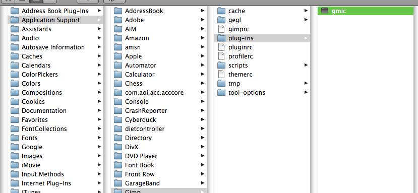

ok, done that... and this is it now (I have added back in the script folder and the plug-in folder, plus the two scripts I have and gmic (which is still not showing in Gimp, and there's no solution on the horizon).
Is it of concern that there are no brushes, patterns, gradients in there?
