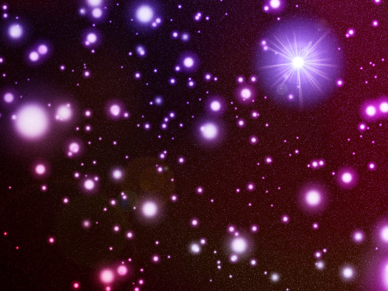

Hellllllo everyone! It's been a long long long long long long did I mention longggggg time(?) since I've made a tutorial! Please bare with me and my horrible instruction skills as I attempt to tell you how to make something like this! xD

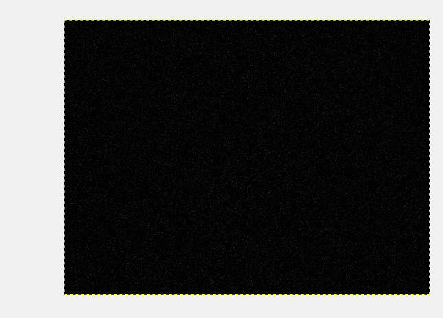

Step one:
Make an image (whatever size you want) with a black background> Go to Filters/Noise/HSV Noise and set it to how ever you like, the noise will be representing far away stars.

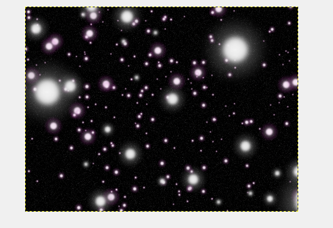

Step two (pt 1):
Get the sparkle brush and turn on jitter to make the sparkle go random and add some sparkles, then go to colorize, you can either make them white by turning saturation down or make them a vague color; I chose option 2.

Step 2 (pt 2):
Now make a new layer and select the sparkle brush again, this time make the sparkles much bigger this is to add perspective, now place at random some bigger “stars” and do the same process with colorize.

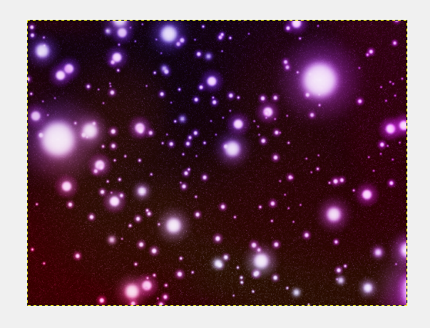

Step 3:
Next make a new layer and get a gradient of your color choosing and make a smooth layer (No repeating settings on) of the gradient, then set layer mode screen, now turn the transparency down I have it to 12.2 but how ever you'd prefer is what matters.
Now make a new layer and make big random color splotches (I used purple, blue and pink) with a soft fuzzy brush then set to overlay and blend them with smudging until it looks good to you.
