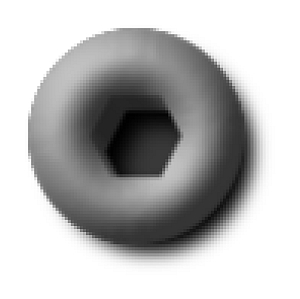

Screws
Screws are not much different from rivets so just follow Steps 1 & 2 for making a rivet but in Step 3, don’t shrink the selection or delete the middle area. Leave the whole gray circle intact. We’ll pick up from step 3 and continue for making an Allen screw head. First let’s change the name of the Rivet layer to Allen screw.
Step 4.
If you have been following these Metal Wurx tutorials you should already have the Hex brush included with the last one for making a hex bolt head. Create a new transparent layer above the Allen screw layer and Select the Paintbrush tool. Select the Hex brush and set the size to 30 pixels. Use the hex brush to place a hex shape in the exact center of the circle.
Step 5.
Right click on the transparent layer with the hex shape you just made, select Alpha to Selection, then turn off the visibility. Reselect the Allen screw layer to make it the active layer and hit the delete key to “cut out” the hex shape from the center. Go to Select>
None to turn off the selection, and your image and layers should now look like this.

the screw looked a bit pixilated/blocky
 Post subject: Re: How to make Rivets & Screws - Metal Wurx - Part IX
PostPosted: Thu Mar 22, 2012 8:40 pm  (#5)
Joined: Jan 20, 2012
Posts: 583
It looks pixilated because it is very zoomed in. If you were to use it though it would appear very clean
