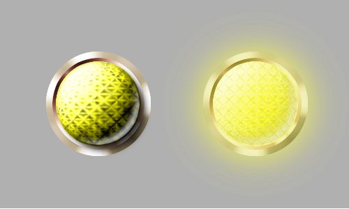

We need to make a few more adjustments since our lights will now be illuminated and radiating light in all directions evenly.
First we turn off the Gradient layer, but there is still a slight overall gradient which is generated by the Sphere layer. For our ON layers to look right we need to create a different Sphere layer without this gradient effect.
Right click on the Sphere layer and select New Layer. When the New Layer dialog pops up, select Transparent as the Layer Fill type and name it “Sphere 2”.
Note: If you are using Gimp version 2.8.1 or above, simply open the Voronoi pattern image from the resources folder provided in Part A - Bezel, place it above the Sphere layer and skip to Step 15.
Go to Filters>Render>Pattern>Voronoi and use the exact same settings for both tabs just as we did in Part B when we created the first Sphere layer and click OK to render the pattern. Here are the settings we used for the Grid Generator tab. (disregard the gradient)
And here are the settings we used for the Visualization tab. (Disregard the gradient)
When you have finished entering the settings, click OK to render the pattern.

Go to Filters>Map>Map Object. On the Options tab select Transparent background and set the Map to window to Sphere again, but this time notice the direction of the light and the resulting gradient in the preview window.
Now click on the Light Tab and where it says Position, change both the X and Y values to 0 and the Z value to 6. Click the Preview button to see the changes, then click OK.
Your image and layers should now look like this.
Step 16.
Our Sphere 2 layer is a little too big so we need to scale it down to fit like we had to do when we created the first Sphere layer. Go to Layer>Scale Layer, set the scale mode to “percent” and set the amount to 78% for both values then click OK.
Once the filter completes the scaling process, right click and select Layer to Image Size.
Now that looks better! Turn off the visibility of the Pattern layer, then turn off the visibility of the other Sphere layer and set the layer Mode for the Sphere 2 layer to Grain Merge and you will see that the light is now evenly distributed and our light is a little brighter overall, but we still have some “spots” to deal with.
Step 15.
Increase your view setting to about 300% for accuracy sake and right click on the Sphere 2 layer to create a new transparent layer above it called “Inner Glow”. Right click on the Lens layer and select Alpha to Selection. Now click on the Inner Glow layer again to make it active, then go to View>Show Guides to get our guides back.
Select the Blend tool and in the tool dialog set the gradient to FG to Transparent and make sure the box is checked to reverse the gradient. Set the Shape to Radial then reverse the FG/BG colors so that your FG is white. Drag from the center of the selection where the center guides intersect down and to the right at a 45 degree angle to the outside edge of the selection to apply the gradient.
Change your view back to 200%, then set the layer Mode to Screen, and the Opacity to 35%. Turn off the selection, then turn off the guides, and your image and layers should now look like this.
This brightens up the outside edges of the lens, as well as correcting the "spots", but as you can see, this unfortunately makes the overall effect way too bright and so we need to tone it down a bit so we can see the red color more.

Here is my "off / on" states of the yellow lamps. I won't bother with all the others. Drac , I really do admire the amount of work that has gone into this tut. Unfortunately, it is very subjective as to what is the best for a an on or an off state. Not only that, but the way that your monitor is adjusted has a big bearing on the final outcome and I notice that even different positions on the screen will present slight variations in colour as does the viewing angle, for instance the slight halo around the yellow on led was not apparent until I flattened the image and saved the file. Thank You
 Post subject: Re: Metal Wurx - XIX Indicator Lights - Part C
PostPosted: Sun Aug 05, 2012 7:02 am  (#20)
Excellent Wooble, You did a very nice job as usual.
