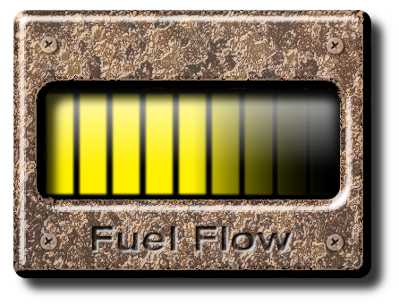

:rofl :rofl I told you this was a monster! It was definitely a massive amout of work and almost not worth the effort but then who's to say. I don't think I ever was happy with the final set of combinations and I still think the yellow and white are a bit too bright to match the other ON condition lights but like wbool63 said, just play with the layer settings and choose what you like.
I'll be posting acouple more in a day or so that have been ready for a long time but I was trying my dardest to get this one finished first. Here's a couple of teasers.
BTW......they're short and sweet compared to this Indicator Light monstrocity.

Here is my "off / on" states of the yellow lamps. I won't bother with all the others. Drac , I really do admire the amount of work that has gone into this tut. Unfortunately, it is very subjective as to what is the best for a an on or an off state. Not only that, but the way that your monitor is adjusted has a big bearing on the final outcome and I notice that even different positions on the screen will present slight variations in colour as does the viewing angle, for instance the slight halo around the yellow on led was not apparent until I flattened the image and saved the file. Thank You

Excellent Wooble, You did a very nice job as usual.
