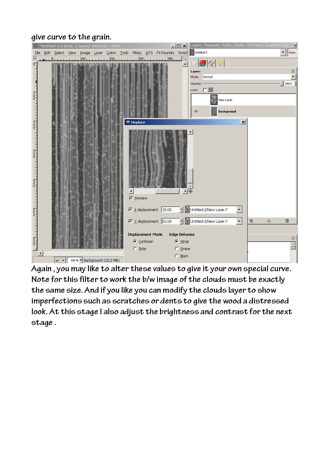

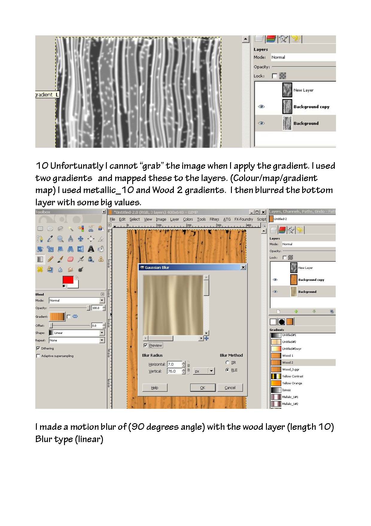

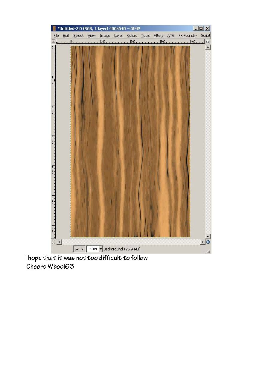

After some suggestions I have updated the pdf to reflect some small changes, They include Erisian's suggestion to use Filter/render/clouds/solid noise in step 5 and use a Gaussian blur instead of a motion blur in step 10. Essentially the tut is the same.

@ Graechan thank you for the offer of scripting this . The step I forgot to write down because it was self evident to me is to turn off visibility after you create a final displacement map (usually the clouds layer), Step 5. Step 10 could probably be modified to a gaussian blur to give more flexibility. I think it will be a difficult script with all the possible variables. Anyway thanks again!

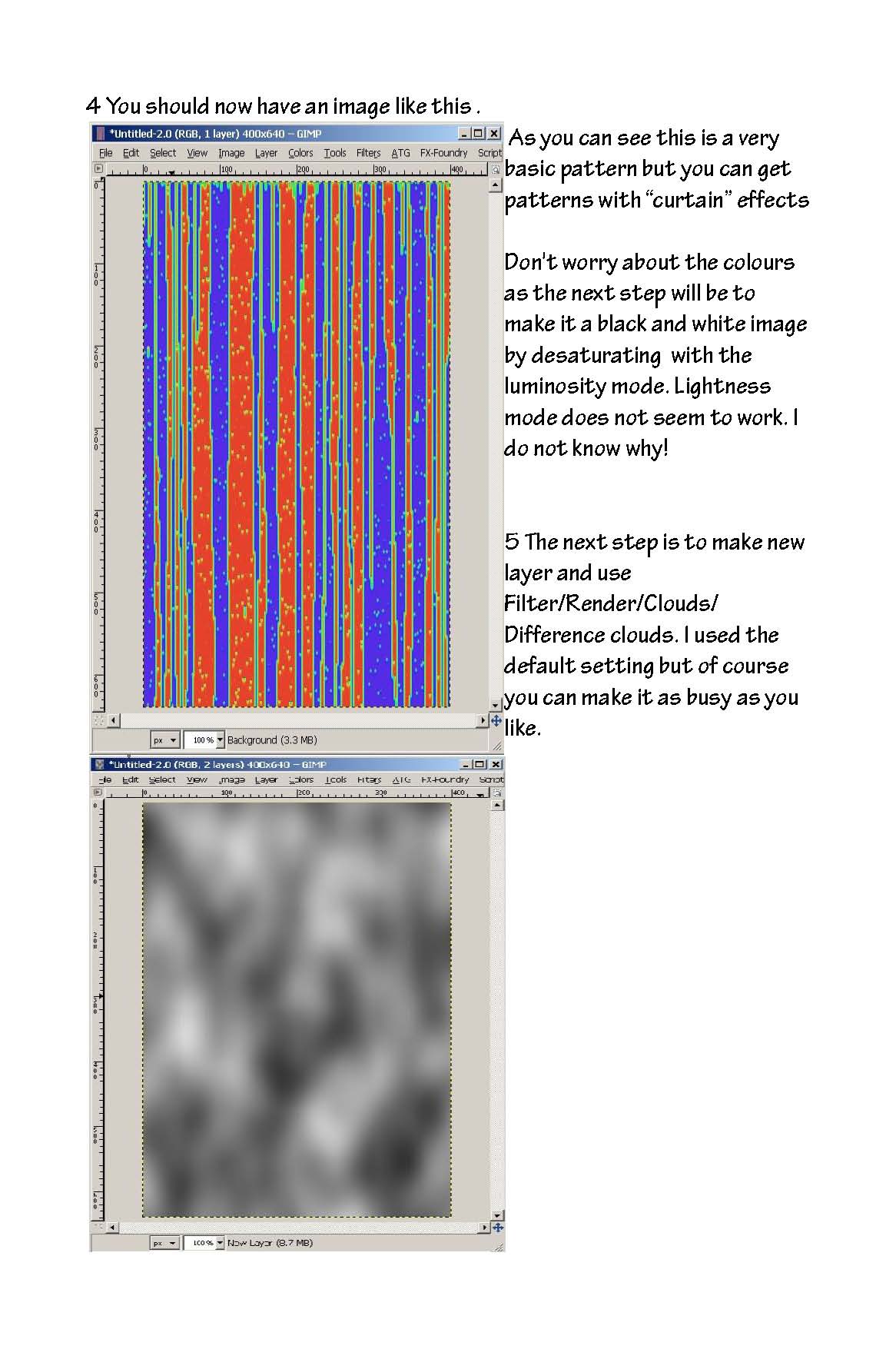

Nice tutorial. Just one thing Wbool, step 5 - difference clouds won't do a thing on a new layer. Do you not mean solid noise clouds?

I stipulated a white background in the first pic and I used and assumed a new white layer to Filter/render/clouds difference clouds. You are right I should have stipulated make a new "white" layer . Thanks for the pick up. I'll wait another day perhaps to see if there any more things I have overlooked and I'll change it. Most people will realise my omission when they cant apply the filter. But I agree your way is simpler and fool proof and renders the same image
