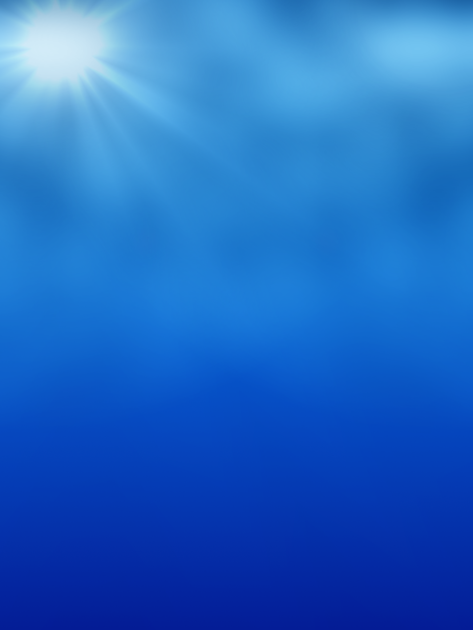

I am new to GIMP 2.8. Basically I am a software developer and struggling in GIMP for one of my IOS game app. I have a requirement of 14 different underwater background images for all different game levels. One of that image is for my menu (home screen) scenes background. I tried several tuts but not achieved a good result.
When i tried to follow
http://www.webdesign.org/photoshop/draw ... .2800.html
At layer#2 it says to use 'Filter/Artistic/Plastic Wrap' which i dont see in gimp 2.8. So stopped here.
I created few images (attached) by following some of the other tuts but I am sure Apple will reject my app if i use this king low quality images....

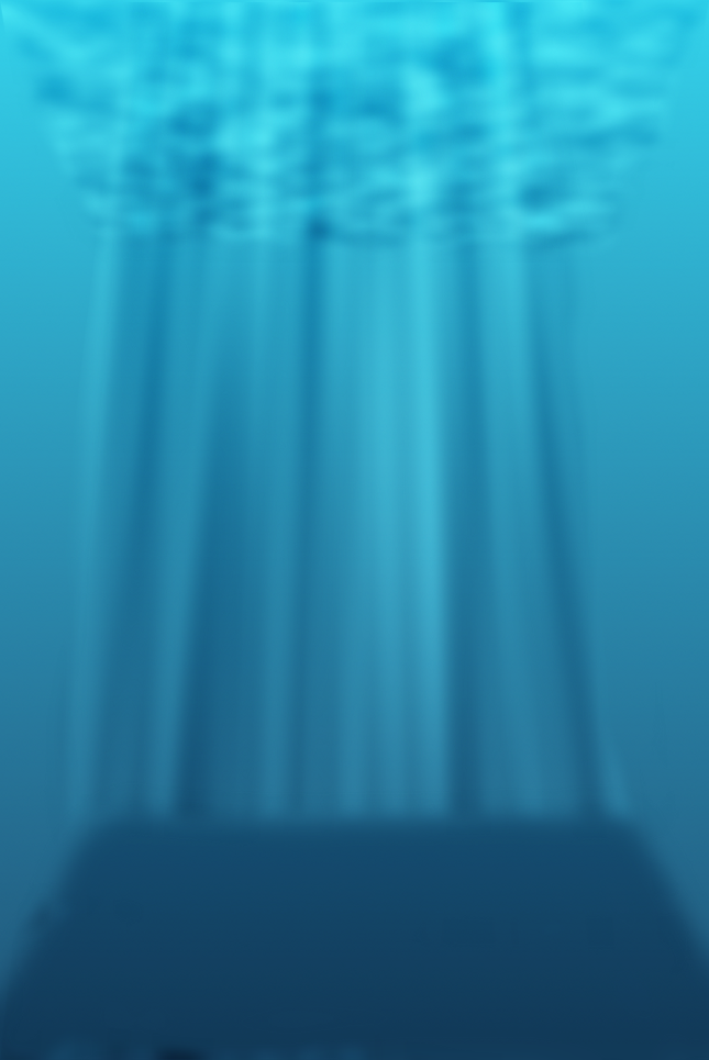

Created this underwater background a while ago now using the tutorial http://zummerfish.deviantart.com/art/Re as inspiration.
Here is a LINK to the xcf file, feel free to use the image as it is or to modify.

This is excellent and nice work. You guys are really such nice and talented persons.
I was following the earlier said link by zummerfish for last 3 days and stuck at how can i do bas relief in GIMP 2.8....
I am really thankful to you. Really appreciate the help you did.
Once again thanks a lot!!!
