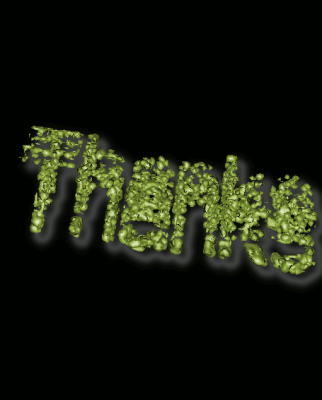

It works great in mcgimp! However...is there a way for the text to be a little less "bubbly" and undone looking?

PostPosted: Mon Sep 03, 2012 11:20 am  (#31)
look at the one that says Thanks David...look at the D in David when it 're-assembles'. It's like parts of the D never quite reassembled on the lower left corner area. When I did it, the same thing happened, and it was a T, so it was very noticeable. It seems to happen on the second word that you enter.

The "bubbly" aspect is implicit to the generation of the 3d object. It is composed mainly of small independent blobs, so that from any point of view, it doesn't look like the text it actually contains. Only two angles will display the two strings correctly. I can hardly make it more smooth, without adding too much informations in the 3d object.
Also, there are some constraints that must be fit by the letter to assure the final 3d object will be consistent. Sometimes, these constraints can't just happen as the same times :p
I would recommend using capital letters, to reduce the amount of text artefacts.
