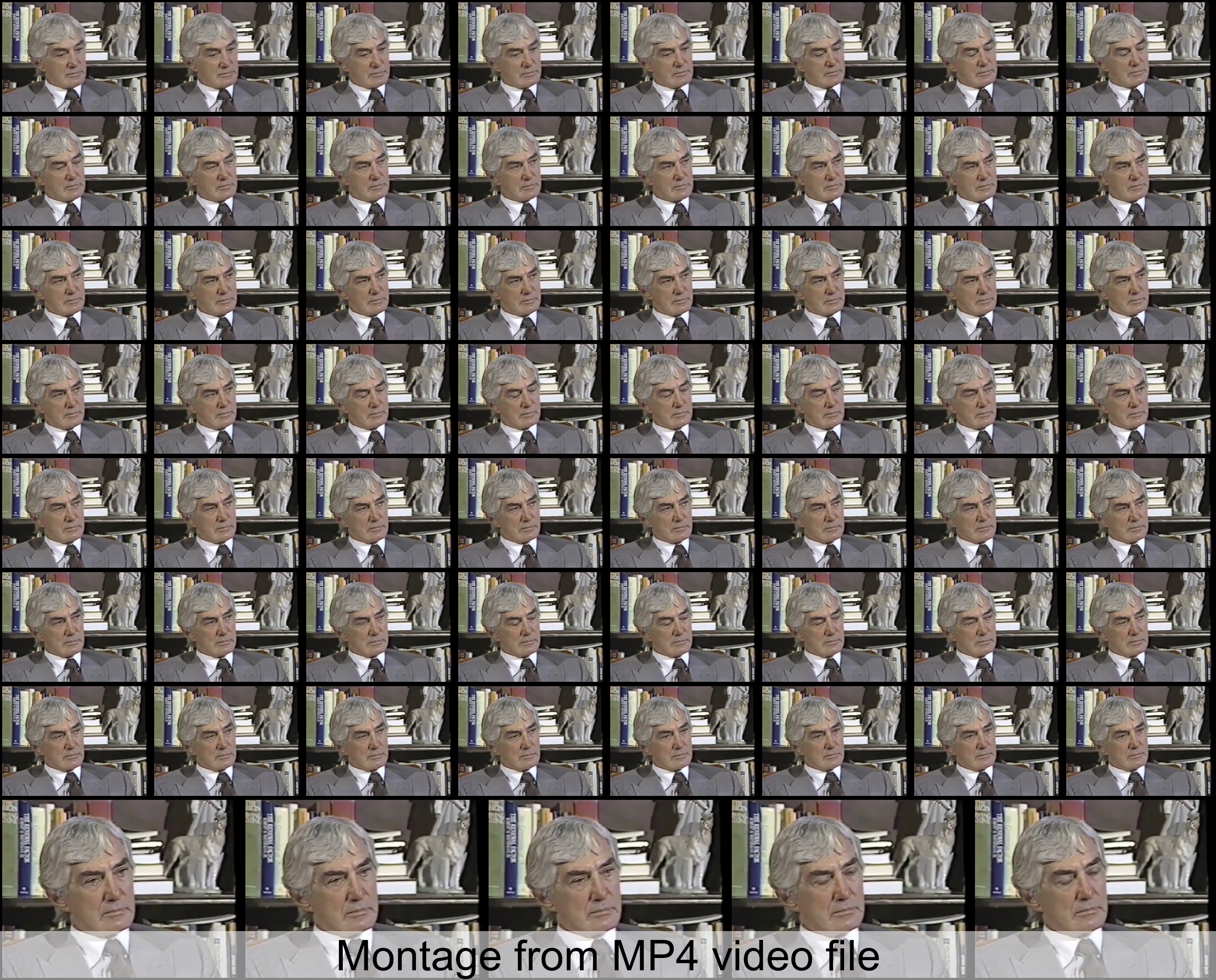

For those interested I've converted the G'Mic command for use with Custom Actions in the Thunar file manager.
Name: Montage - 75% Scale, 5px Frame
The Command:
for file in %N; do gmic %N -gimp_montage 4,\""V(H(0,1),H(2,V(3,4)))"\",1,0.75,0,5,0,0,0,255,0,0,0,0 -o --0000.jpg
Appearance Conditions: Select image files.
The command for Montage - 50% Scale, 5px Frame:
for file in %N; do gmic %N -gimp_montage 4,\""V(H(0,1),H(2,V(3,4)))"\",1,0.5,5,0,0,0,0,255,0,0,0,0 -o --0000.jpg
The command for Montage - 100%, 5px Frame:
for file in %N; do gmic %N -gimp_montage 4,\""V(H(0,1),H(2,V(3,4)))"\",1,1.0,0,5,0,0,0,255,0,0,0,0 -o --0000.jpg
Now I can just right click on a bunch of images and click the custom action and the montage is created without the need to use the command line.
I don't know if the creator has thought about this, but it would be useful to "market" this tool as a way to create contact sheets of video files. The tool would probably have to be modified a bit so that frames could be skipped, but it would work well I think. I just tried using the Thunar G'Mic Custom Action on an 2 second MP4 video file and G'Mic successfully converted it to a montage. It also works on animated gif files. See examples attached.

Here's the Thunar Custom Action to create a contact sheet from a video, with 1 frame every second:
gmic %N -keep[0--1:24] -gimp_montage 4,\""V(H(0,1),H(2,V(3,4)))"\",1,1.0,0,5,0,0,0,255,0,0,0,0 -o -0000capture.jpg
I can modify this at some point to work with YAD or Zenity, so a box pops up asking for a custom frame capture.

@serche : the problem with your latest command (for the videos) is that G'MIC first loads all video frames in memory, and then discard 23/24 of them, which is not really optimal in term of memory consumption.
You should instead load only 1/24 frames of the video files, like this :
gmic %N,0,-1,24 -gimp_montage 4,\"\",1,1.0,0,5,0,0,0,255,0,0,0,0 -o -0000capture.jpg
EDIT: I've just discovered a bug that causes G'MIC to hand if the video does not have a number of frames which is a multiple of 24. I've found a fix, but I need to release new binaries to make it working for everyone.
EDIT2: I've build new beta packages with the fix included, available on the G'MIC sourceforge file server : https://sourceforge.net/projects/gmic/files/beta/
