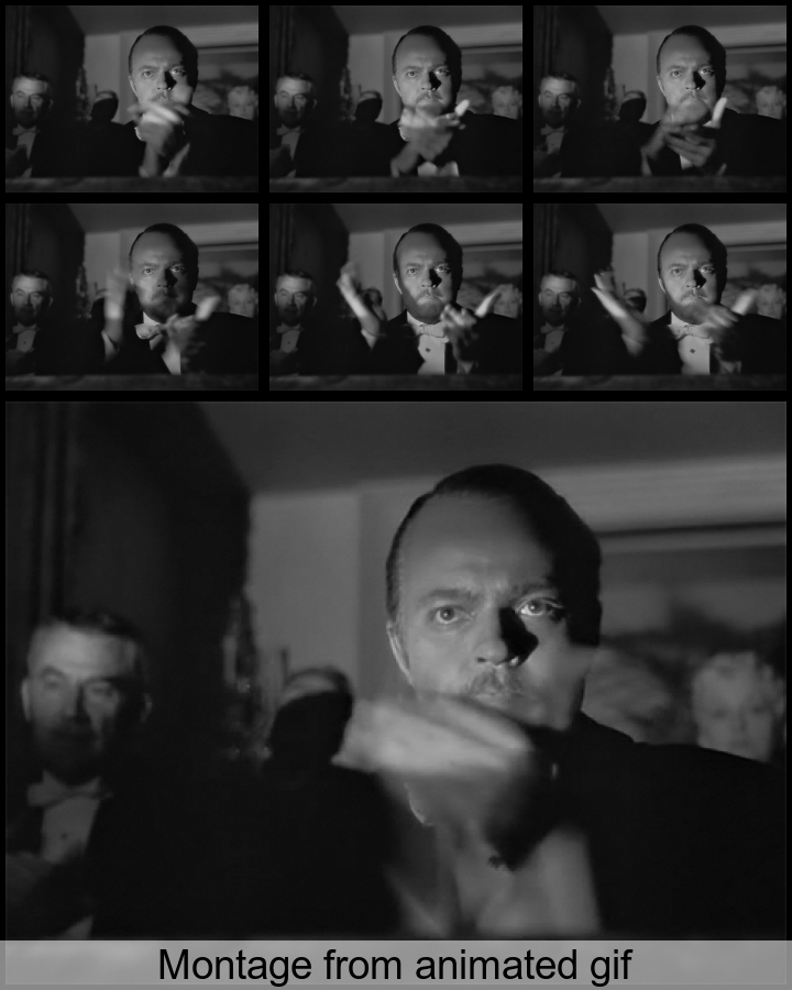

For those interested I've converted the G'Mic command for use with Custom Actions in the Thunar file manager.
Name: Montage - 75% Scale, 5px Frame
The Command:
for file in %N; do gmic %N -gimp_montage 4,\""V(H(0,1),H(2,V(3,4)))"\",1,0.75,0,5,0,0,0,255,0,0,0,0 -o --0000.jpg
Appearance Conditions: Select image files.
The command for Montage - 50% Scale, 5px Frame:
for file in %N; do gmic %N -gimp_montage 4,\""V(H(0,1),H(2,V(3,4)))"\",1,0.5,5,0,0,0,0,255,0,0,0,0 -o --0000.jpg
The command for Montage - 100%, 5px Frame:
for file in %N; do gmic %N -gimp_montage 4,\""V(H(0,1),H(2,V(3,4)))"\",1,1.0,0,5,0,0,0,255,0,0,0,0 -o --0000.jpg
Now I can just right click on a bunch of images and click the custom action and the montage is created without the need to use the command line.
I don't know if the creator has thought about this, but it would be useful to "market" this tool as a way to create contact sheets of video files. The tool would probably have to be modified a bit so that frames could be skipped, but it would work well I think. I just tried using the Thunar G'Mic Custom Action on an 2 second MP4 video file and G'Mic successfully converted it to a montage. It also works on animated gif files. See examples attached.
