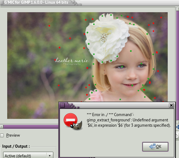

David, that looks great but where do I find the Linux Beta 16.01 version? 'I tried it with the 1.6.0.0 version and this is the error I received.

Thanks grosood, I downloaded and installed the beta version and I put the green dots on the girl and the red dots on the bg and the thing is going back and forth for 15 mins now. I don't know if it is working or what it is doing. Is there a chance that I should be using a smaller preview, or does that make a difference?

Graechan wrote:
Is anyone compiling a 64bit for Windows
Doing so now Graechan. Will post a download after successful testing. :bigthup

@grosood. I was still putting dots in when it was working, I guess, I am still very confused, as usual, I will try to give it another go. So I just have to put a green dot on the foreground and a red one on the bg, :gaah
