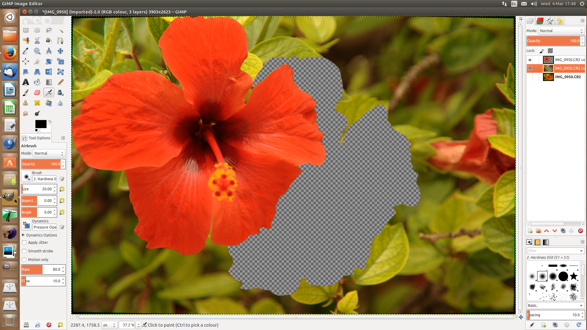

I have just downloaded G'MIC 1.6.1.0. (Linux - 32 Bit).
I ran the "Extract Foreground" filter and had a peculiar result. The upper layer (foreground) is displaced to the left and up with respect to the background layer.
I have tried this on three photographs with similar results.
Is it something I am doing wrong, or is their a problem?
I used the previous version earlier today with no problems.
I have attached a screen shot of the result.
david.

Since my last message (above) I have replaced gmic_gimp with version 1.6.0.4 and run foreground extract on the same photograph with perfect results.
The Gimp was telling me that there was an update available, which of course was 1.6.1.0 beta. I downloaded this and installed it. (In case I had a bad download previously.)
When I ran foreground extract I had the same problem as previously.
I hate to be the bringer of bad news!
david.
edit: I should have added that it looks perfect in the preview window.

Thanks David, thanks Silvio.
Indeed, I confirm a regression for the 'Extract Foreground' filter. I'm working on a fix.
I think this can be fixed simply, just by updating the filters, no needs to reinstall a new binary.
Thanks a lot for your report !
I'll post a message when the fix is ready.

OK, so please press the 'Filter update' button, the filter should work again, as in the previous version.

Downloaded, installed and tested. Extract foreground is perfect again.
Many thanks for all your hard work.

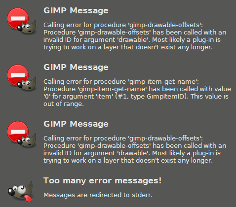

1)
Filter > Circle abstraction always crashes when I apply it (no matter the jpeg image I have tried to work with)
Here is a video with all my steps until the final error:
https://dl.dropboxusercontent.com/u/309 ... _CRASH.mp4
Here is the log for this oroblem:
https://dl.dropboxusercontent.com/u/309 ... tion_crash

 Post subject: Re: Request beta-testers for upcoming G'MIC 1.6.1.0
PostPosted: Fri Mar 06, 2015 3:37 am  (#96)
Joined: Jan 03, 2011
Posts: 1656
Thanks again Silvio for your report.
I've been able to reproduce the bug on my Win7 64bits too, so I'll try to find what is going on (no idea right now :) ).
Concerning the 'Colors to layers' filter, I'm not surprised. Your input image contains anti-aliased colors, which actually means a lot of pixels with different colors, and potentially a lot of output layers (each output layer contains a 'pure' color only).
As there is a limit in the number of output layers, the filter does not have the time to output the layer with the red circle, because before reaching the corresponding pixels, it has already detected pixels with at least 16 different colors, and when the maximum number of layers is reached, it stops the decomposition.

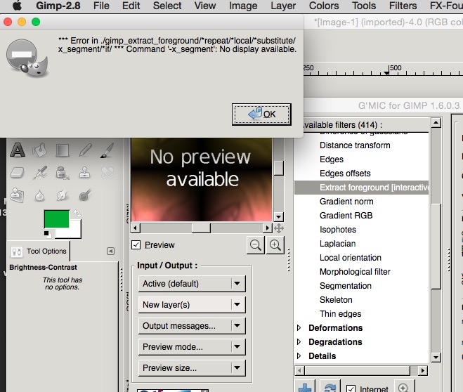

Any clue what this is about? I really had wanted to try out the foreground extract in G'MiC. I was using a one layer photo and did click OK, then nothing happened and I was back with the original photo. I am using Partha's McGimp, currently G'MIC has 414 filters after refresh.
PostPosted: Fri Mar 06, 2015 1:26 pm  (#99)
Posts: 1656
2ton, I believe the Partha's build does not enable the G'MIC interactive display (it requires X11 on Mac), that is what the error message tells at least.
You won't be able to run any of the interactive filters unfortunately with this build.
