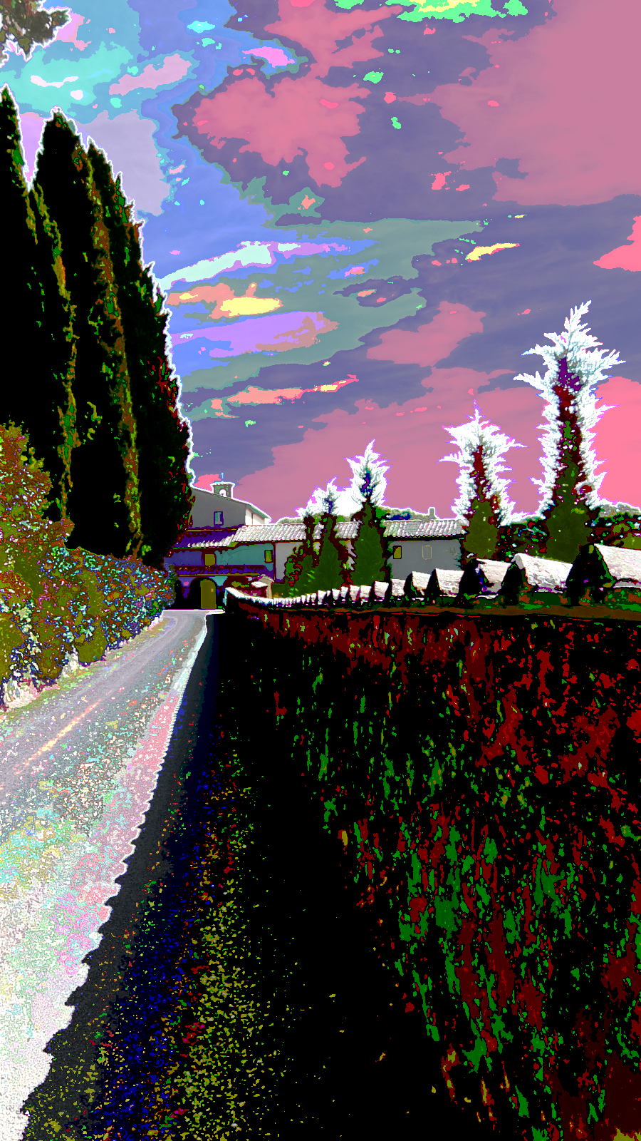

we may now make use of an additional tool (still G'MIC), for instance:
Pattern/ Plasma
by default the mode remains Grain extract, which is good also for the additional layer created
(third transformation)

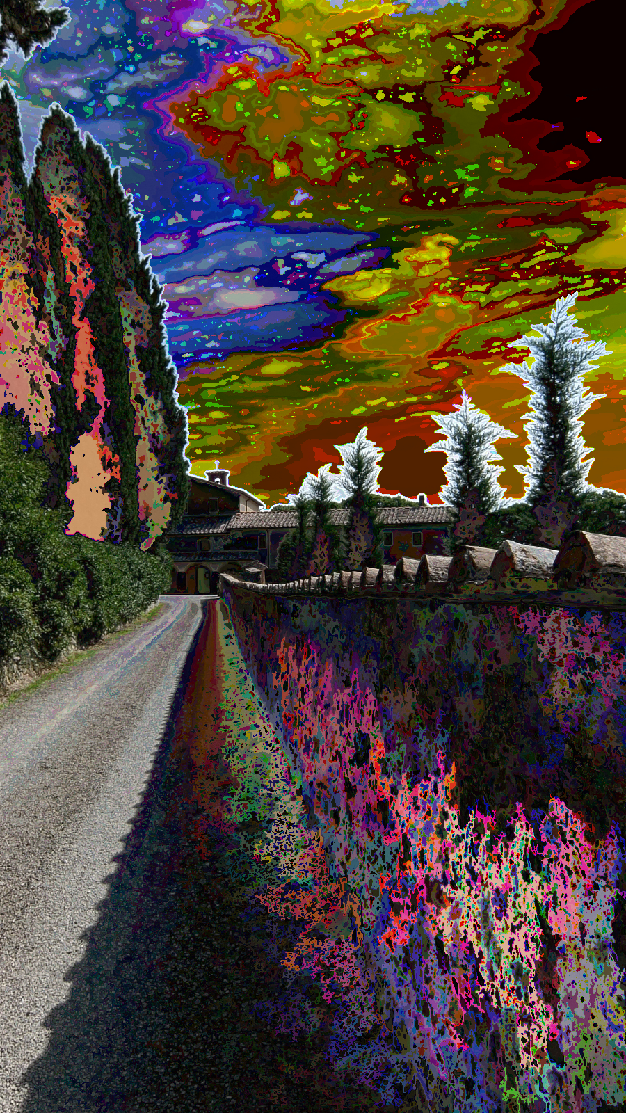

we select the Abstraction layer as active and go to
Pattern/ Crystal
(fourth transformation)

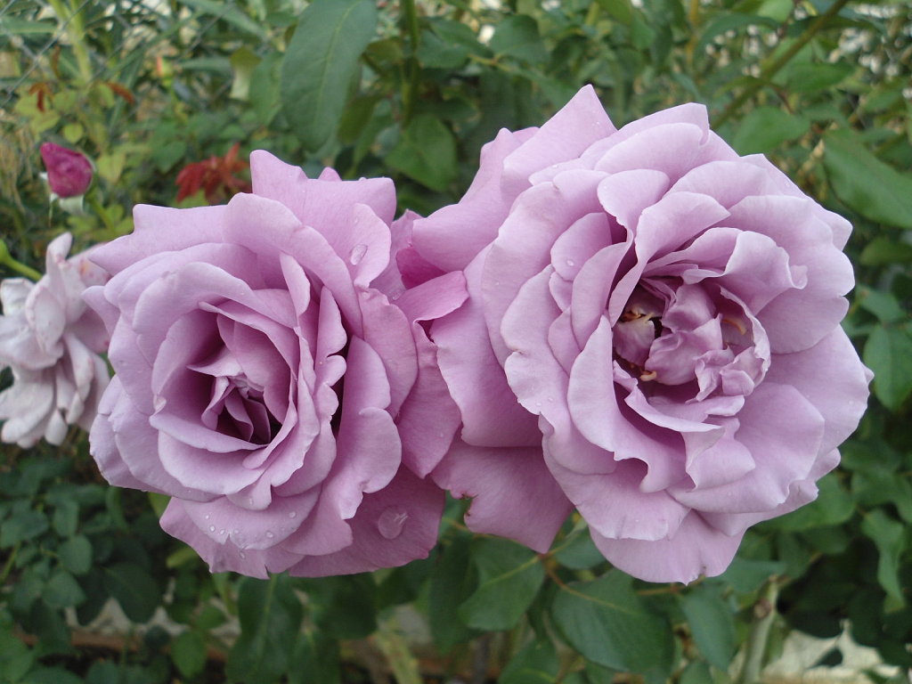

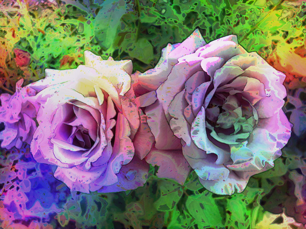

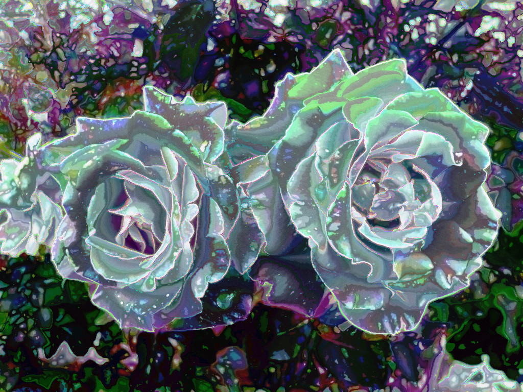

I did two tries, Dinasset. And I like the outcomes a lot. Thank you for sharing your methods. :bump
Plasma; opened the picture, G'MIC - Colour - Abstraction 1, 16, 0.2, 0 and put layer mode multiply, and opacity 75%. Then G'MIC again Patterns - Plasma:
0.5, 0, 8, opacity 75% and layer mode Divide.
Yag; G'MIC - Colour - Abstraction - 1, 19, 0.2, 0 Layer mode Colour, Then G'MIC Details -Yag effect 90, 90, 0 opacity 75% and layer mode Grain Extract.

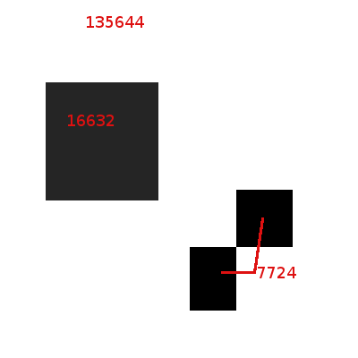

Hello dinasset,
They have me on the arabic desk today. I just picked up your ticket.
I have an image to help me out. Sorry. It is not as pretty as any of the ,
others here, but it will help me explain the concept of 'connectivity', one of the
argument flags that the G'MIC -area command takes. It is also a
concept necessary for tabulating area and has broad applicability in
the field of computer vision. You'd probably like knowing about it.
The concept of 'area' means pretty much what it says: the command
determines the area of of contiguous, or 'connected' regions. Here,
regions are established by pixels which have common properties. In
this image, I'll use only one property: color. The image has two
colors: black and white. We can intuit that there seems to be one
black region and perhaps three white regions, Maybe a total of four.
The total has been thrown into doubt because one might argue that the
two regions just touching at a corner are, in fact, just one
region. That's a conundrum I'll defer.
Computers have no intuition. Instead an algorithm must unambiguously
establish regions. This is where the concept of 'connectivity' comes
into play.
Two pixels sharing common properties, 'like pixels', are deemed
'connected' if and only if at least one path can run from one to the
other without traversing unlike pixels. Regions consist of mutually
connected pixels. Put informally, the command attempts a flood-fill
and sees how far the flood goes. A flood-fill tests connectivity at
each pixel it attempts to engulf with the nearest pixel already
engulfed.
There is still an ambiguity. What of the (one? two?) regions just
touching at a corner? Resolving that ambiguity is what the
connectivity flag argument to the -area command is for. When it is set
to zero, low connectivity, two regions just touching at corners, are
deemed unconnected; you are not allowed to run a path through that
narrow defile. Set it to one, high connectivity, and you are; the two
erstwhile regions are considered as one.
In many images, what might be considered a region has fuzzy borders.
That is where the tolerance argument comes into play. When it is zero,
two pixels must have exactly the same value in order for them to be
'like' pixels. Set it to a positive value, then you permit pixels,
unequal but with differences less than the tolerance, to be considered
as like pixels.
With an unambiguous means to establish regions, -area can then tabulate
areas. It reports these using gray scales; the intensity value of all
pixels in a particular region are set to the pixel count (in effect, 'area')
of that region.
Here's what the -area command reports about this test image, using low
connectivity (flag=0) on the top and high connectivity (flag=1) on the
bottom. The numbers are not part of the image, but report the values
assigned to pixels in each region.
Now let me see if I can find an image and play in this game.
Take care
Garry

-area 0
-area computes areas of connected regions; see the opening remark of
this post and the previous post. Here, it suffices to remark that tiny areas
such as rock cracks, will be dark, and vast areas, such as the sky will be
light. In my opinion, the surreal aspect comes from this reassignment of
intensity which is not especially governed by the original light source
in the image.

I continue playing G'MIC and its wonderful filters on my photos. Getting nice results. :bigthup
Thank you Dinasset for your introduction and tips to play with G'MIC. :tyspin :bump
 Post subject: Re: SURREAL using GMIC
PostPosted: Thu Mar 05, 2015 11:31 am  (#17)
wonderful birds ... and wonderful outcomes!
the roses are your "pièce de résistance" ....
