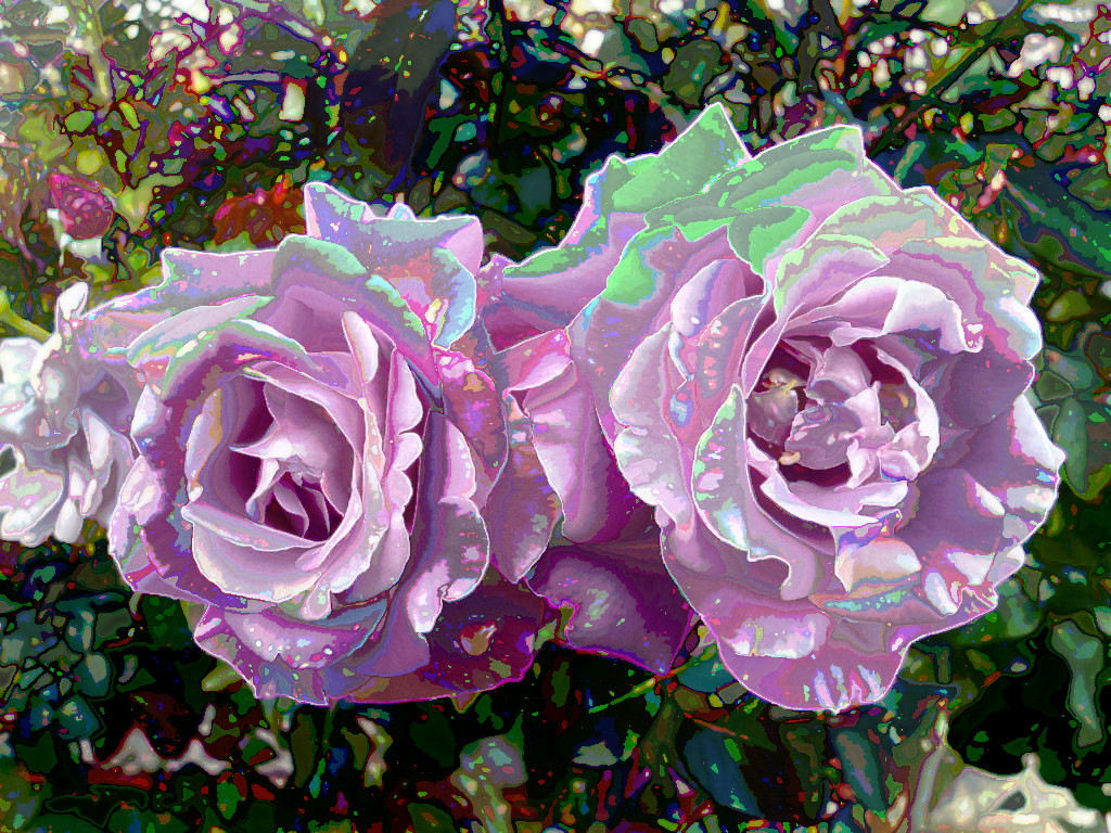

We take a photo
(original)
we go to G'MIC/ Colors/ Abstraction
the filter shows the default values of the parameters (1.00, 10, 0.20) and so the default preview.
we change output mode to New active layer (which is always the best thing to do with G'MIC filters) and OK
(first transformation)
a new layer is created with the default transformation, which is already nice per se
but...you may also play with layer mode and see more surreal transformations
we set the mode to Grain Extract, for instance ...
(second transformation)
even nicer, isn'it?

we may now make use of an additional tool (still G'MIC), for instance:
Pattern/ Plasma
by default the mode remains Grain extract, which is good also for the additional layer created
(third transformation)
we are still in search of more "sur-reality"?
we select the Abstraction layer as active and go to
Pattern/ Crystal
(fourth transformation)
So far, we used almost all default parameter settings.
But we may change on the main filter used (Abstraction) the Levels number and get quite different but almost always interesting outcomes.
If we use levels=75 and Layer Mode=Difference we get this outcome:
(fifth transformation)
this filter has almost infinite possibilities of transforming the image.
 Post subject: Re: SURREAL using GMIC
PostPosted: Thu Mar 05, 2015 11:31 am  (#17)
wonderful birds ... and wonderful outcomes!
the roses are your "pièce de résistance" ....
