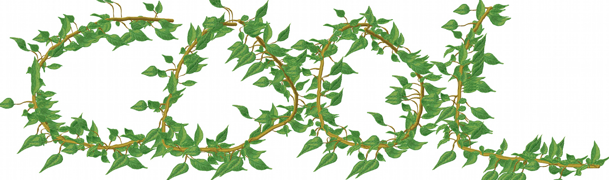

This is probably one of the best animated brushes I've run across for GIMP. Have no idea how it was created; the transitions are near flawless. Looks like he dropped off the planet after posted just a few Deviations. Anyway, I wonder if anyone knows of a barbed wire, rope, or other brush that come's close to this brush. Please let me know. :)

Wow, that's a really nice brush. I opened it in GIMP hoping it would give me a clue about how it was made. It has a lot of layers. I also downloaded his two spatter brushes and they have even more layers.
I think part of the way it was done was multiple layers with the shapes in multiple places on the layers. It's something I'm going to play with and see what I can come up with. One of the spatter brushes has 94 layers. Urg. That's a lot of layers.

Still, weird that he posted only two brush and dropped off the face of the planet. I did do a search on his name and found that he also did help a few others with their brushes too but not too many hits. Again, I didn't even know you can get such flawless transistions with gih brushes until I saw this one. Of course my motivation was to create topiary (thanks to 2-ton for increasing my volcabulary by one word; lol) renditions with vines and got tired of the one that came with GIMP. I have a not so impressive rope brush and indeed even created a yarn brush myself but not 100% happy with it. How this person created the vine brush and made it so near flawless just took me aback some. I've seen some vector programs demos that made brushes of this calibre but not a GIMP brush until this one. Now I want a barbed wire and a good rope brush. I again asketh for too much. lol

Nothing magic at all. He brush is just a whole bunch of "stem" circles with the same conical gradient so it looks like a 3d pipe/wire/tube an a whole bunch of stem circles with a "twig" and a leaf attached, all in different directions. The brush is simple "random" selection, nothing angular or anything fancy.
There are 40 "stem" circles and 25 "leaf" circles. Drag the spacing way out and draw a line to see the cells.

The vine part in the vine brush is static, it doesn't turn or anything. The leaves have the vine brush at the ends of the leaf stems and groups of the leaves are rotated around a common center which is the vine brush.

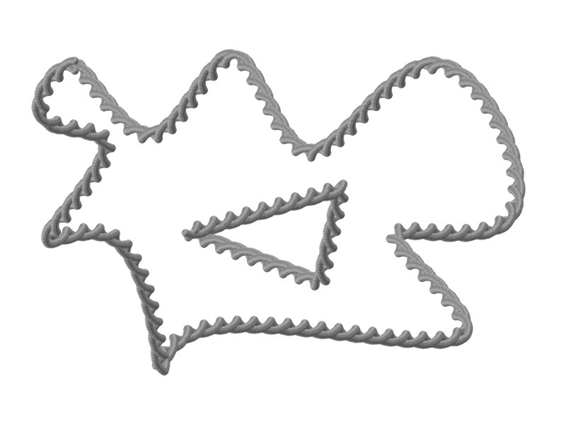

I was trying to do twisted wires and ended up with this oddity -
Brush attached.
-Rob A>

Thanks again, RobA. That one's yummy even if I'm not sure what it is. Another toy brush to play with.
