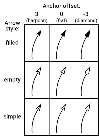

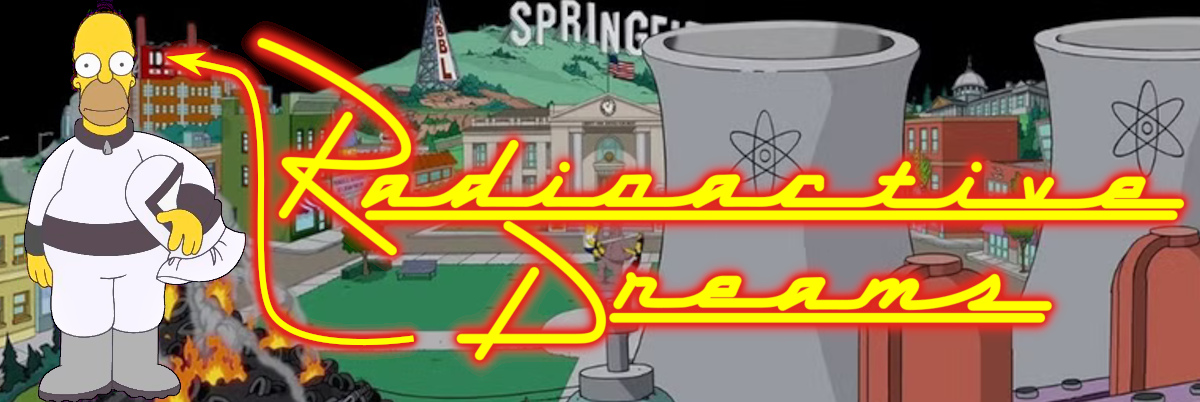

This is my proposal for a plugin dedicated to a much requested feature in GIMP 3.0: stroke paths with an arrowhead at the end.
It has one genuine feature, compared to other similar plugins (AFAIK): the body path is shortened to ensure that the arrow tip ends up reasonably well aligned with the path's last point.
This apparently trivial feature actually hid a rabbit hole. The requirement of cutting a Bezier curve at a specific point send me through a deep dive into Bezier curves theory and algorithms. :-)
The image below shows a selection of arrowheads styles available:
