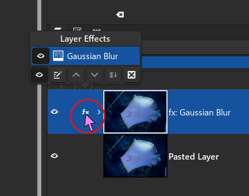

Hi TeaMouse,
Yes to both! That is exactly the point of this plugin.
1. Readjustment:
Because this uses GIMP 3's new non-destructive editing (NDE) features, it is not a one-time thing.
You can double-click the filter icon on the generated layer group at any time to bring up the settings dialog and readjust the values.

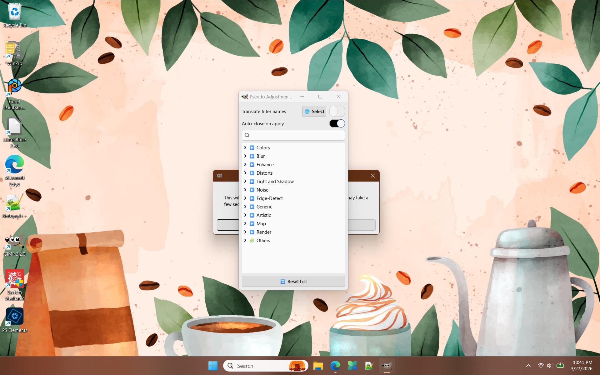

Things did not go well
Did a reset list and the window popup behind as shown in image. Once
I pressed the Enter Key I got a list of error messages on the right. Close everything and tried again.
This time I move the adjustment window to the far left and still the same thing.
Couldn't get Gimp to close this time, so I had to go to the task manager and close Gimp there. But
still had this.

Thank you for providing the screenshots and detailed feedback! Let me explain what is happening.
1. The popup hiding & Error messages:
The error messages you saw on the right (Error Console) are completely normal. When you click "Reset List", the plugin automatically tests all filters in the background, and unsupported filters send an error to the console.
Regarding the confirmation popup hiding behind the main window (which forced you to use the Task Manager) — I have already fixed this bug in my local development version! The next update will prevent this from happening.

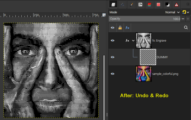

If you look closely at your first screenshot, there is a small ">" icon next to "fx: Engrave". The plugin DID create a layer group, but it is set to be collapsed by default.
This is actually intentional! The goal of this plugin is to simulate Photoshop's "Adjustment Layers", which are single items in the layer stack. To recreate this in GIMP 3, the plugin uses a Layer Group containing a hidden "DUMMY" layer (which is technically required to add filter and a mask). By keeping the group collapsed, it looks and acts more like a single Adjustment Layer.
However, there IS a UI refresh bug in GIMP 3.2.2 where the layer tree doesn't visually update properly sometimes (which is why you had to Undo/Redo). I have added a workaround in the next version to force GIMP to refresh the UI immediately.
An update is coming soon. Thanks for testing!

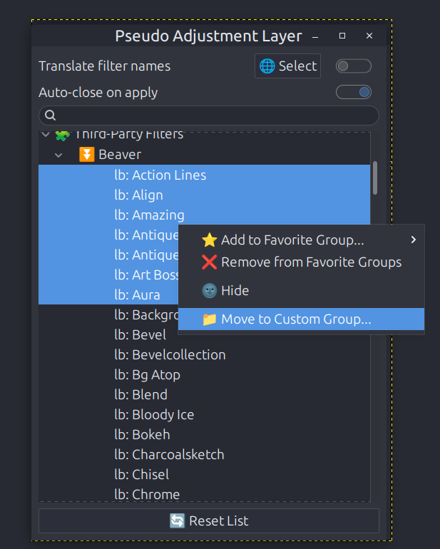

Pseudo-Adjustment-Layers Ver1.8 is released.
New features:
- Multiple Filter Selection
- Multiple freely named Favorites
- Organize third-party filters by grouping
- Translation setting function from the plugin UI
GIMP3-Pseudo-Adjustment-Layers Ver1.8

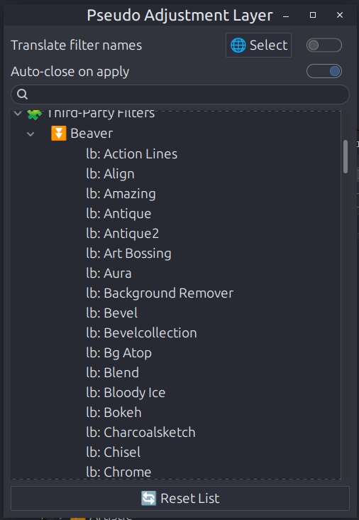

The only remaining issue is the search in 'Third-party Filters'.

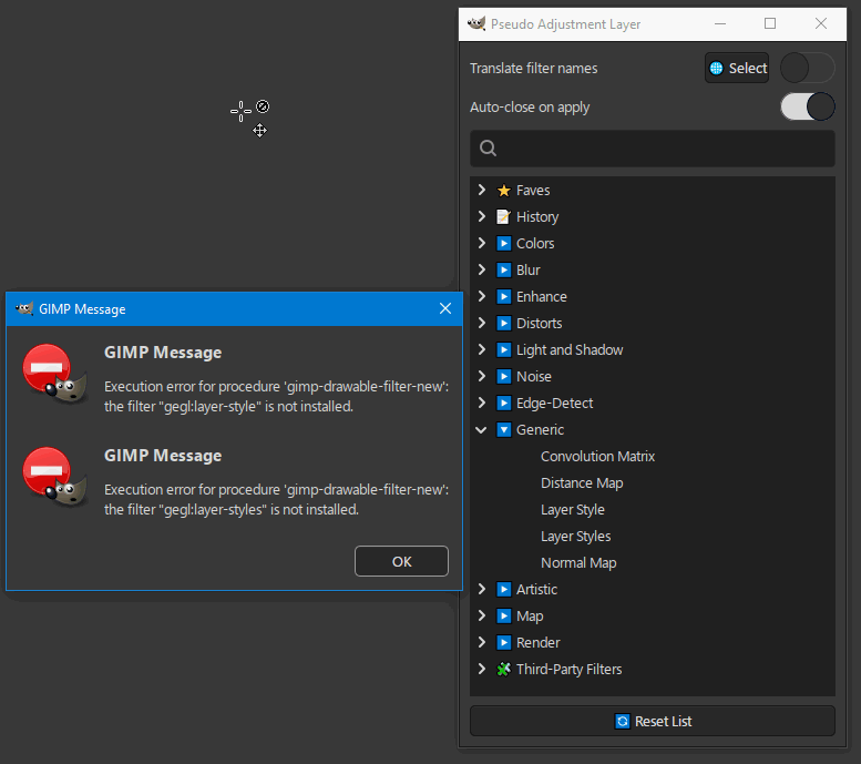

If Text Styling = Layers Styles, then the plugin is using the wrong procedure.

Search in "Third-Party Filters":
You are a lifesaver! I checked the search code and found a silly bug. The search function was accidentally skipping categories that had specific emojis (like the puzzle piece for Third-Party Filters and the star for Favorites). I have completely rewritten the search logic to be fully recursive. It now works perfectly!
Layer Styles wrong procedure:
You are 100% correct again. "gegl:layer-style" and "gegl:layer-styles" were incorrect internal names (likely leftovers from an older version). I have updated the code to use the correct procedure name "gegl:styles" (Text Styling), and removed the invalid ones. It works without throwing errors now.
