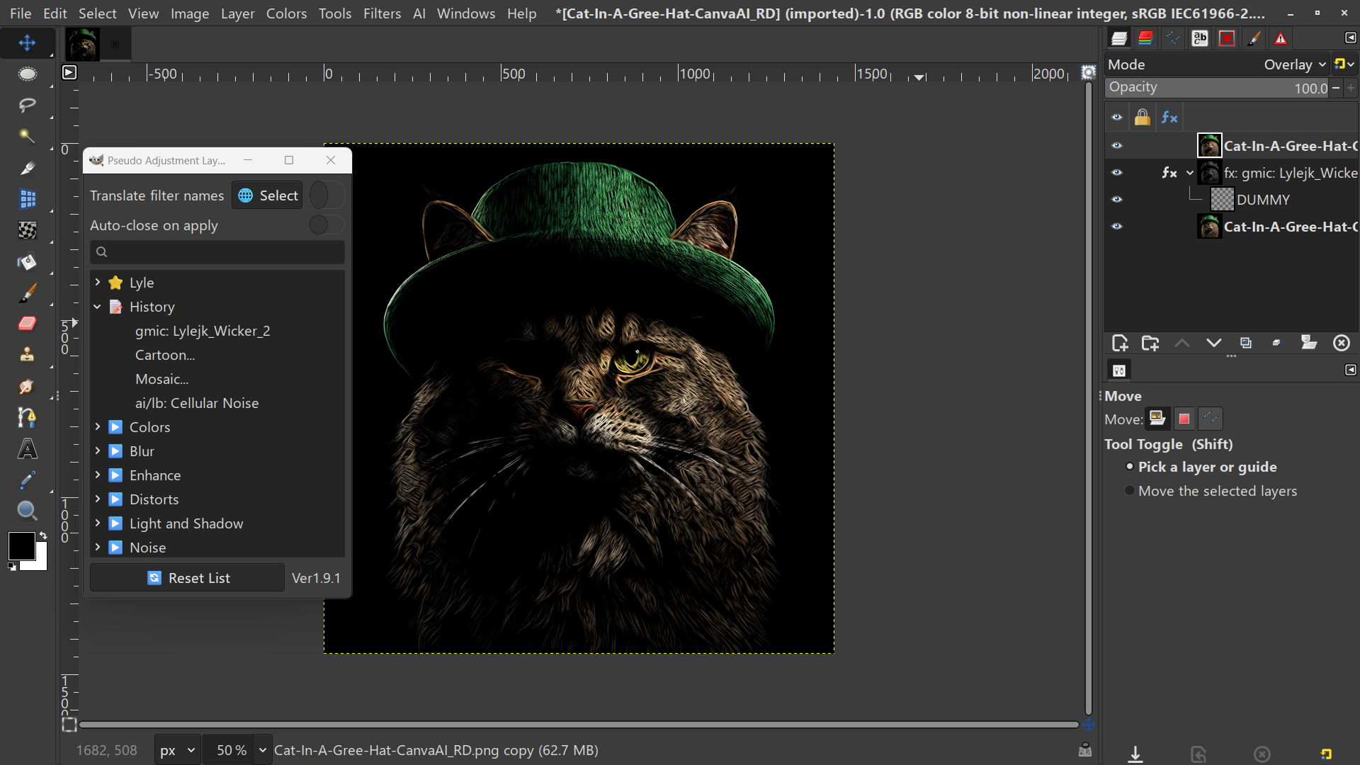

[Update] Pseudo Adjustment Layer Ver 1.9
Pseudo Adjustment Layer Ver 1.9 is now available.
Download
https://github.com/yousei3/GIMP3-Pseudo ... tag/Ver1.9
This is primarily a maintenance update. I have reviewed the entire script and focused on fixing various bugs and UI inconsistencies found in Ver 1.8.
One important fix concerns the official Drop Shadow. It was previously thought to be a plugin API issue, but I discovered that in GIMP 3.2.2, the internal procedure name has changed to gegl:dropshadow (removing the hyphen). This version has been updated to use the correct name.
However, please note that applying Drop Shadow to a Layer Group often behaves unreliably due to incomplete NDE support in GIMP 3.2.2. For instance, when you group the adjustment layer with a target layer, the contents might temporarily disappear. You can sometimes force the image to reappear by opening the filter settings and toggling the preview on and off, but it remains unstable.
I have also confirmed that this issue does not occur in the GIMP 3.2.1 Development Version AppImage.
It seems to be a regression specifically in GIMP 3.2.2.
Please give it a try and let me know if you encounter any further issues!

@ROD:
I have released Ver. 1.9.1 which fixes only the problems reported to us in a big hurry!
I simply made it so that the message that appears while the Reset List is running is not fixed to the front of the display.
So (thanks for waiting 20 minutes!) There is no need to replace it from Ver1.9, which is now available.
I will continue to develop with this specification from now on, so you won't have the problem of messages occupying the screen. Rest assured!
GIMP3-Pseudo-Adjustment-Layers Ver1.9.1
https://github.com/yousei3/GIMP3-Pseudo ... g/Ver1.9.1

Hey all,
It was more of a struggle to suppress both the error popups and the console output than I initially thought, but I finally managed to do it.
However, it took a lot of trial and error to get to this point. Successfully suppressing the console output was honestly a bit of a fluke after trying various workarounds. (It might actually be a bug in GIMP itself.)
Therefore, I'm releasing this as a test version.
It seems to be working well in my environments: Linux Mint, and Windows 11 with GIMP 3.2.2.
If possible, please test it out in your environment and let me know the results!
GIMP3-Pseudo-Adjustment-Layers Ver1.9.2Beta
https://github.com/yousei3/GIMP3-Pseudo ... r1.9.2Beta

@MareroQ:
Thank you! I'm glad to hear it's working well.
At this point, I’ve pretty much covered all the features I initially planned for this version.
My main focus now will be maintaining compatibility with any GEGL changes in future GIMP releases.
I’m also keeping an eye on the API—if dockable windows ever become available for plugins, I’ll definitely look into supporting that.
If you have any interesting ideas, feel free to share! I’ll see what I can do to incorporate them.
