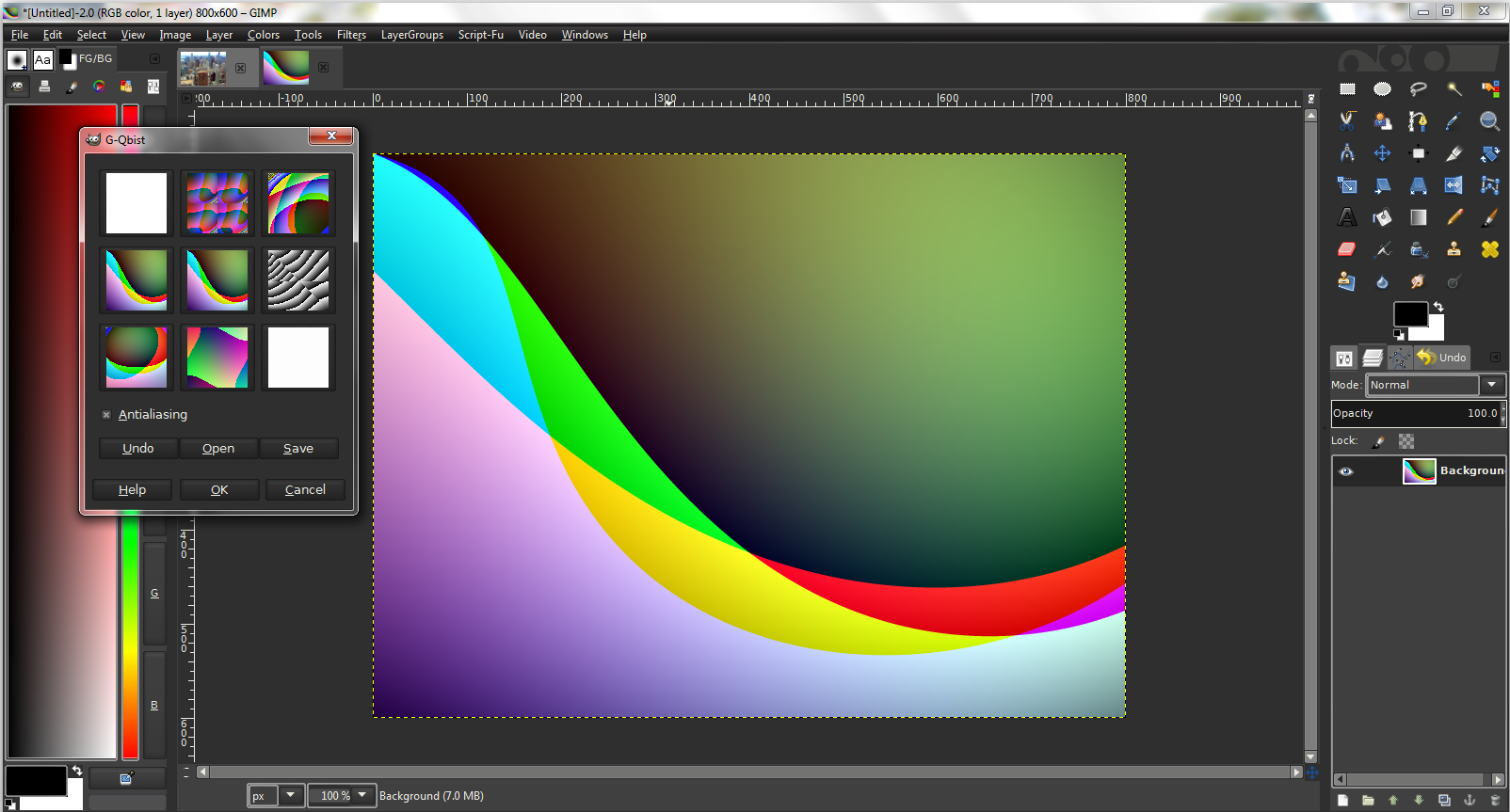

for some quick ribbon like backgrounds you could cheat and use render/pattern/Qbist, there'a a lot of different ones, click on one and it will show some more

alc59: that's interesting! i've never found a use for the qbist filter beforem, but i obviously didn't explore it enough.
thanks for poining that filter out ! :heart
its all random though, is it ?
