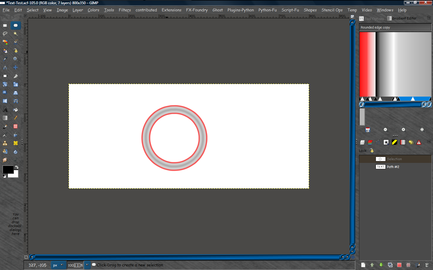

TheBikeMan wrote:
It's the same result Ofnut. I also tried with the paths that Rod so kindly provided and it's still the same. This is what I get...
I've tried every adjustment for the gradients and paths that I can imagine and always get the same result.

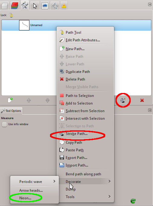

This look like you are using StrokePath and not Decorate/Neon, ie you are using the red circles instead of the green one:

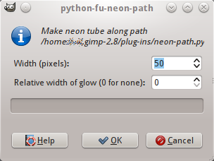

The green one should lead you to a dialog like this:

ofnuts wrote:
Oh I've been using the Decorate/Neon the whole time. It was just the dynamics that were forcing the effect I have been getting.
