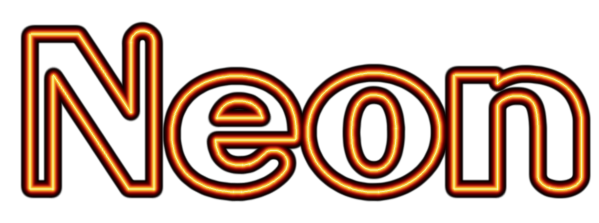

I think my neon-path script is more suited than wrapmap in this case: here a path "neonized" with the "incandescent" gradient:
See http://gimp-path-tools.sourceforge.net/ ... #neon-path

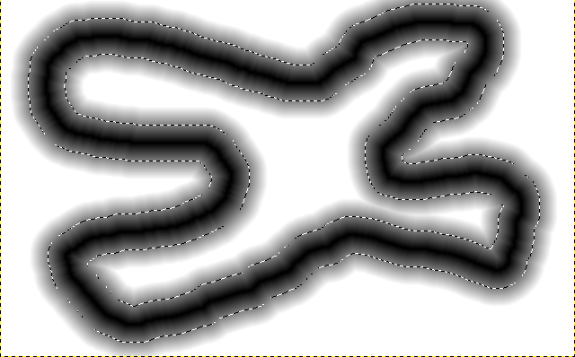

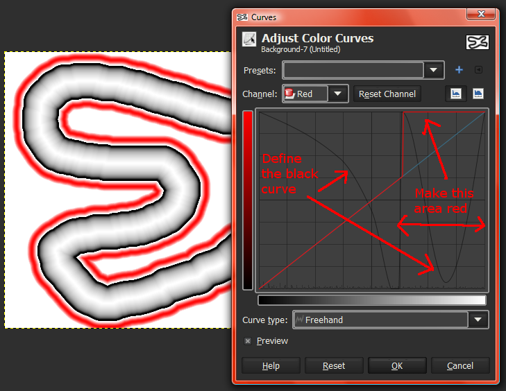

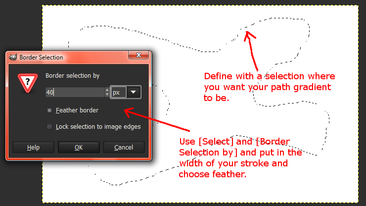

Here's another way to do it. Start off by defining where you want your stroked gradient by making a selection. Then use the border selection dialog box to define the width of your stroke and make sure to use Feather.
Then with the feathered selection past a forground color of black onto your white layer. Which will look like this.
Then use the curves dialog box to 1) create the rounded stroke on the value channel. And then in the red channel use the Freehand pencil tool to flatten the line so that the outer part of the value curve turns red.
Then use the Fuzzy Select tool set to no antialias and a threashold of 0 to select and delete the white area of the layer. And delete all the unwanted stroke areas.
You can also save the curve by hitting the plus + sign in the curves dialog box.

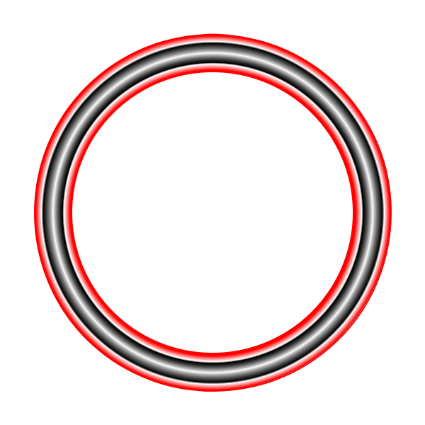

is this what you want?
 Post subject: Re: Heya Gimpers! Boy do I luv Gimp but man am I frustrated
PostPosted: Fri Apr 12, 2013 4:00 am  (#19)
Joined: Apr 10, 2013
Posts: 23
YESSSSSSS! WHOOHOOO. PLEASE TELL ME HOW!
PostPosted: Fri Apr 12, 2013 4:13 am  (#20)
thats super easy :mrgreen:
make some guides: vertical and horizontical at 50% each
make an elliptical selection so that you get a circle that expand from the middle of the canas
set your gradient's shape to 'radial'
set the 'offset' of your gradient to approx. 80%
stroke gradient from the middle to the edge of the selection on a transparent layer
make another selection from the middle of your canvas but smaller
cut (or apply layermask if you prefer that)
and thats it
