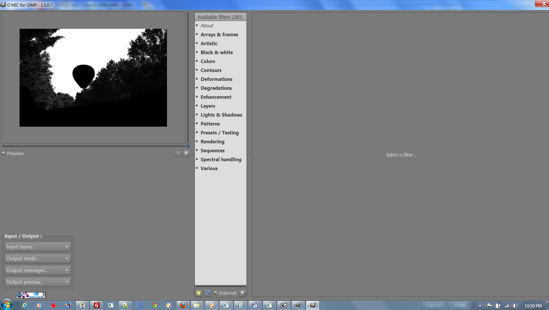

2)GMiC maximize button doesn't work with 2,7
Something like this? It works on my machine for 64-bit Gimp.
File comment: Gmic Maximized
Do you get an error or nothing happens?

yes i mean that
no error but nothing happens
 Post subject: Re: Introducing Gimp 2.7.5
PostPosted: Sat Dec 24, 2011 7:53 am  (#20)
Joined: Mar 14, 2011
Posts: 998
PhotoComix wrote:
yes i mean that
Does the same thing happen with the 32-bit version from the G'mic website?

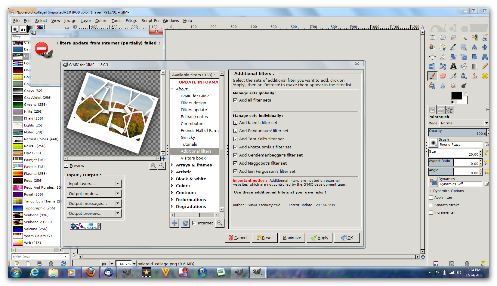

PostPosted: Sat Dec 24, 2011 12:10 pm  (#22)
Posts: 16329
GMIC 32 bit worked fine for me (maximize) and restore.
It did seem to want to freeze up when i opened it and clicked refresh right away.Could have just been my machine though.After i closed it and reopened then used the boxes about>additional filters> and ticked all those, clicked apply and then refresh it refreshed the scripts just fine.
I have not had time to test my tablet though.Has anyone tested theirs yet? (32 bit version)

It won't update for me
PostPosted: Sat Dec 24, 2011 5:07 pm  (#24)
Posts: 998
Do you have another version of curl in your path or perhaps we can ask David about this?
I fixed curl that I am including with G'mic because of not being able to download compressed files.
