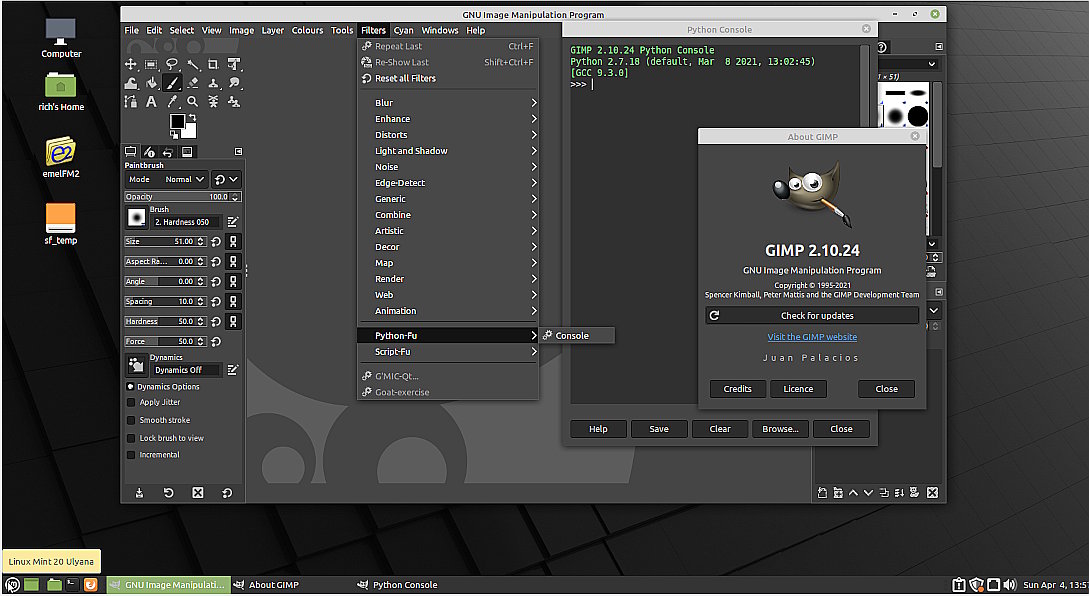

I run Gimp AppImage
OS is Linux inside my ChromeBook
It is working fine.
I download the AppImage From this link
Doron.

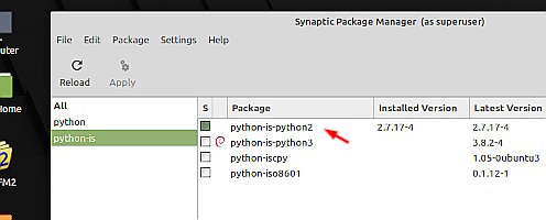

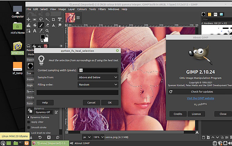

see: https://www.gimp-forum.net/Thread-Heal- ... 4#pid18354
Trying to remember the gory details ;)
Needed this package as well python-is

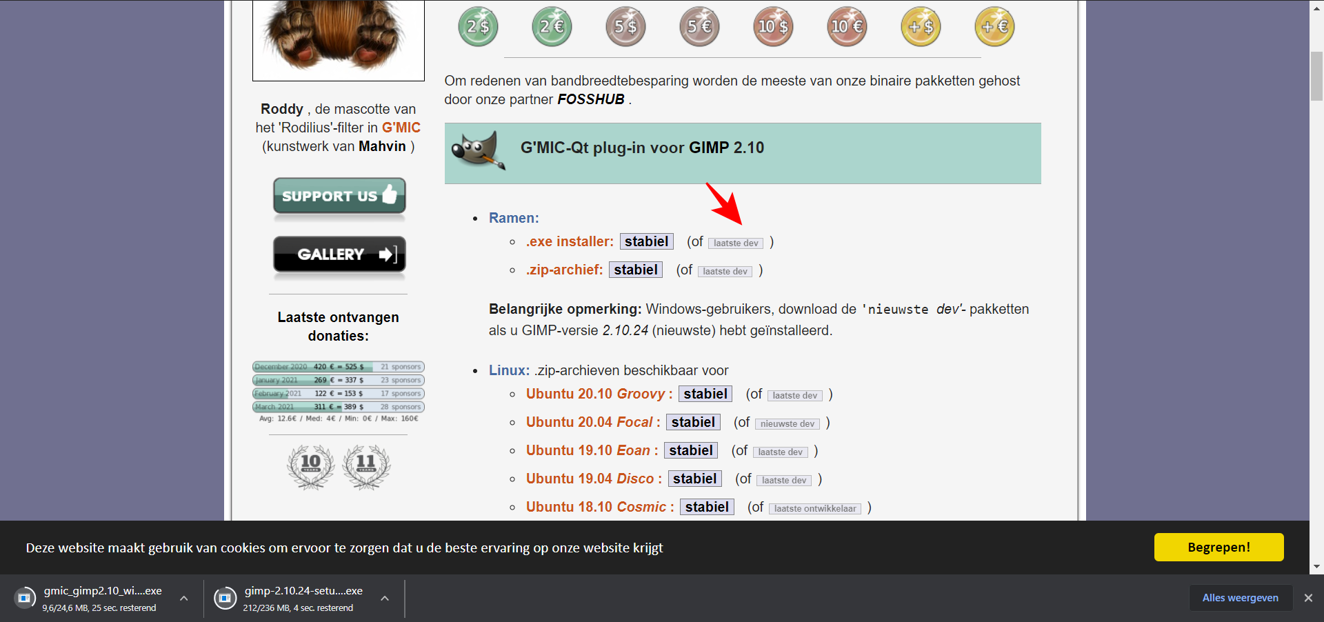

Uninstall Gimp and uninstall G'mic Install the latest version of Gimp (2.10.24) then install G'mic 2.9.7
pay attention! Last dev (see picture)

Gimp 2.10.24 from PPA: Resynthesizer (or is it the python plugins) not working. You still have gimp-python installed ?
You should run Gimp from a terminal with --verbose switch and look for error messages.
Resynthesizer + heal-selection / heal-transparency from here: https://www.gimp-forum.net/Thread-Gimp- ... 1#pid11261 Unzip, put in ~/.config/GIMP/2.10/plug-ins/ Works for me in Mint 20 / Gimp 2.10.24
Edit: That is looking a bit old: Just added the 2.03 version. No difference in functionality, just the resynth gui layout. Checked it with Mint20 and works ok.
