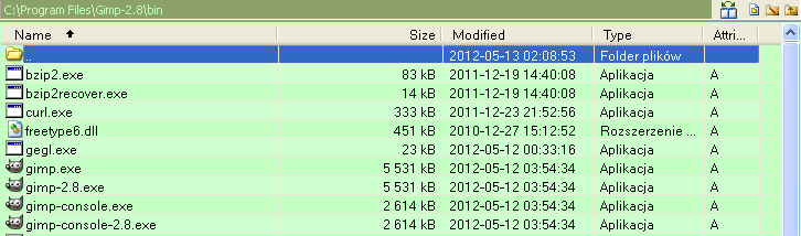

The question of curiosity:
why in the bin directory is gimp.exe and gimp-2.8.exe?
