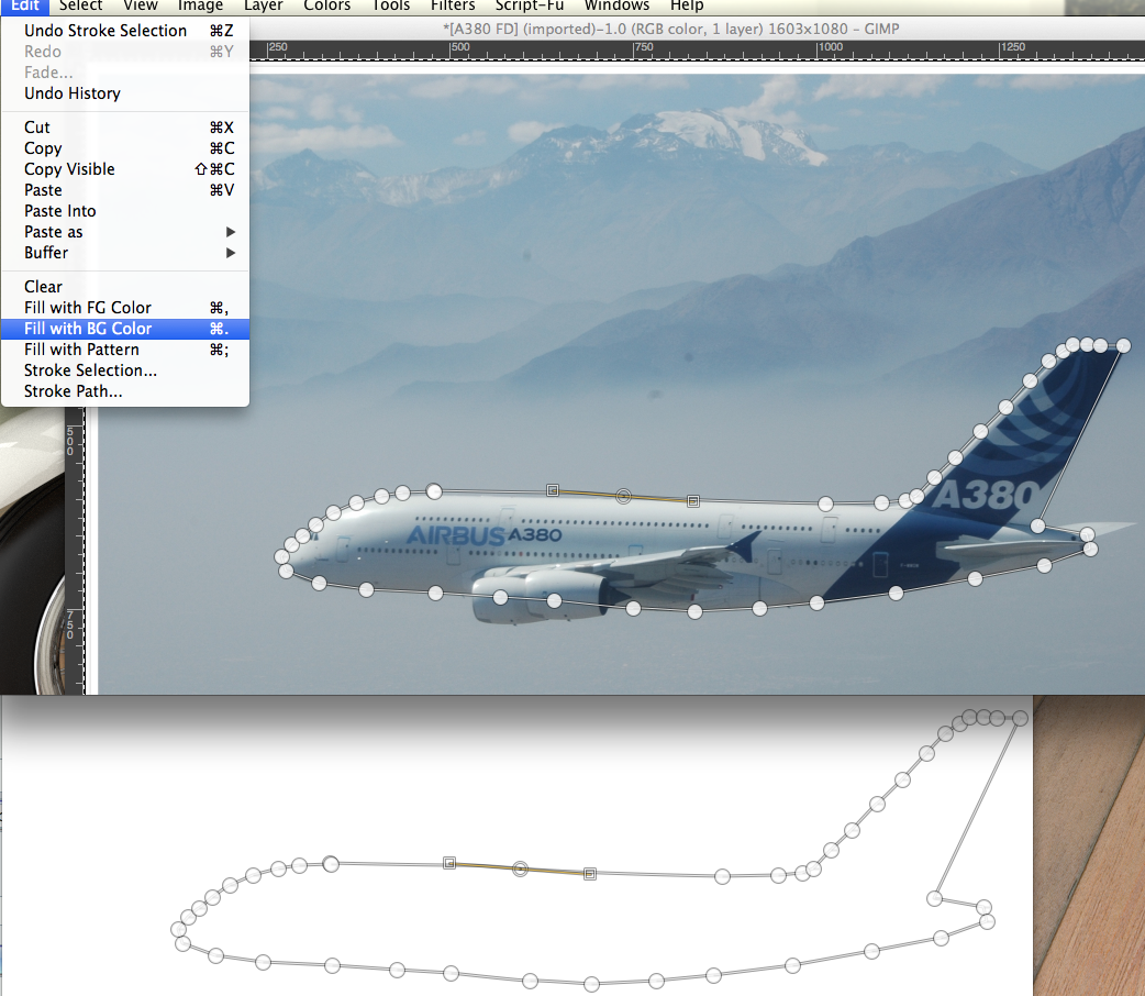

I use Path tool and I think it work, but the first path and the last one don't connecting to each other?
I think I doing something wrong because everything turned white.

Lurifax73 wrote:
Thanks all of you.
Use Ctrl+click to connect the start and the end anchor points. You'll also notice the change in the Path tool's tooltip.
P.S. Well, on Mac it is a Command key I think.

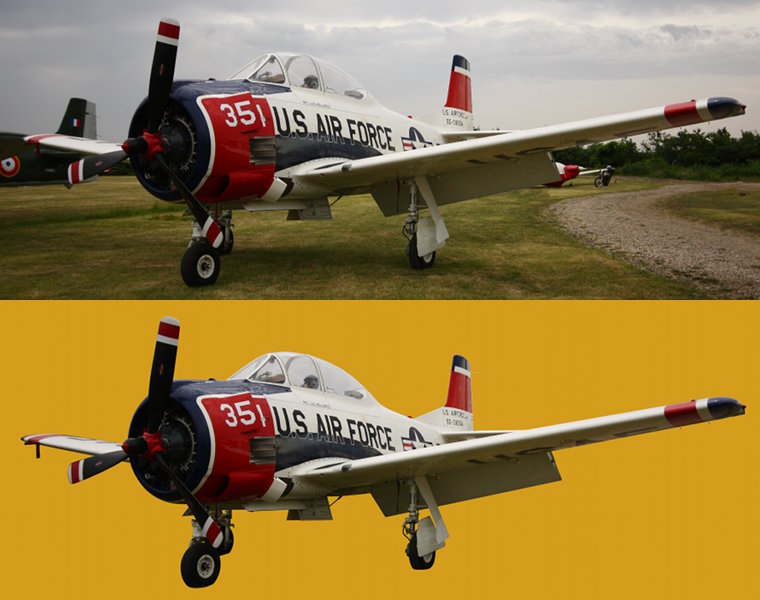

I happen to be working on a plane too... I spent a bit under two hours, for 290 points (actual image size is 3700x2100):
Excellent Ofnuts!
I looked for any failure, but the details were all preserved. Image
The fact that the cockpit is not transparent helped.
Technique and patience, commendable! :clap

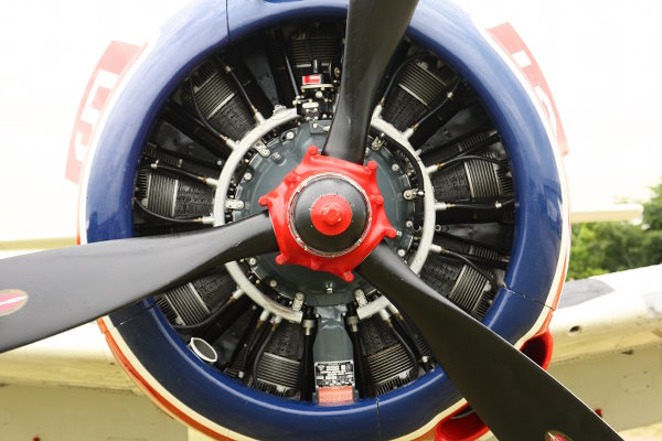

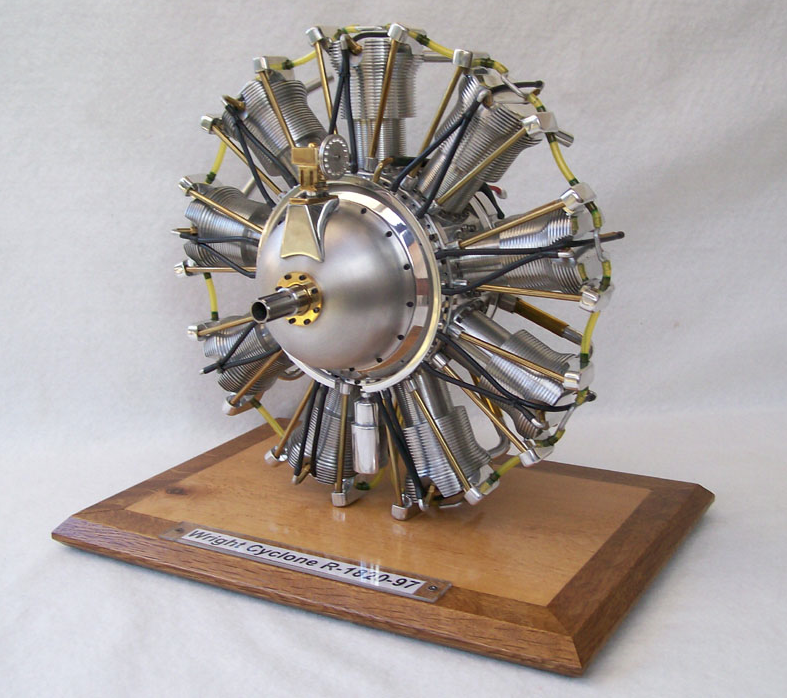

Wery good ofnuts. Looks real. Do you know if there is a star engine on that machine. I made one few year ago for my Blender made Tiger Moth.
Late 2017 iMac Retina 4K 21,5 inch Mac OS High Sierra version 10.13.4
3,6 GHz Intel Core i7
16 GB Ram 2400 MHz DDR4
Graphic card Radeon Pro 560 4096 MB
Affinity Photo and Affinity Designers.
 Post subject: Re: Separate A380 from the background image
PostPosted: Fri Jul 25, 2014 3:46 pm  (#18)
Yes it's a good ol' Wright Cyclone:

ofnuts. If you like this one I going to make one.

Cool model...
