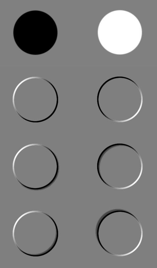

It depends on your mental expectation of the light source.
Here is a bump map of a raised (white) and lowered (black) heightfield.
I selected the lighting to be from the Lower Right, but if you are mentally expecting it to be from the upper left it will appear backwards.
By adding different shadow options (bottom two sets) the effect can be enhanced.
-Rob A>

IT is the shadow that provides the visual cue to whether it is supposed to be carved or raised. Otherwise one looks like the other with a different lighting orientation.
