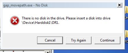

I updated GAP2.6 with GAP2.7 (downloaded from Sourceforge)
but every time that I click on Video commands only, this warning appare
but if I click over "cancel box" 2 times I am able to continue without problems
CAN SOMEBODY TELL ME HOW I CAN AVOID THIS WARNING?
another minor thing is that disappeared the Enhance in Video>layer>Attribute
I made some limited tests and it seems working
Thank you for your suggestions
