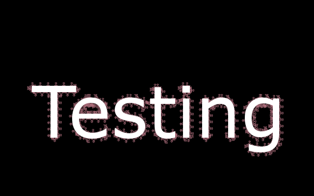

Hi. :) I've followed the tutorial with the brushes I have and this is what I end up with. I can't get the brush to be clear. Just looks like a blur.
Thanks!
 Post subject: Re: Lining a lace edge up on a path?
PostPosted: Sat Apr 11, 2015 12:30 pm  (#5)
From what I can see, you should have used a lighter background or a brighter color for the lace and you should check your spacing before you run the lace path. Try going through the tutorial again, step by step then if it doesn't work out again, post your xcf as an attachment.

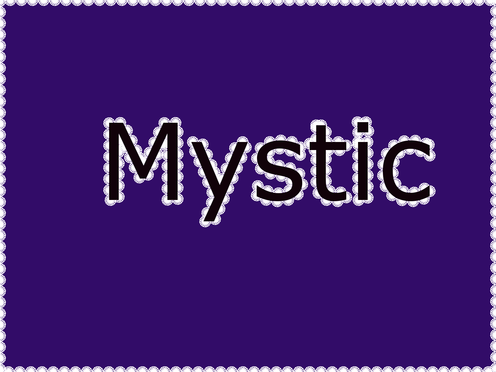

I used my lace brush and I did it by just stroking and it turned out fine.
I attached my XCF below too.
After you do the text, go to alpha to selection > Select NONE > then select to path
Use the lace brush I attached below and paint and change the spacing until you get the edges to touch but not over-lap., then go to paths, use this icon at the bottom :pap then change the tool to paintbrush click stroke. DONE

Thank you all. I did get it to work with the doily brush like you did Molly. I just can't seem to get it to work clearly with any other lace brush I have. I'll go give this a try and see what I get.
:)Thank you!
PostPosted: Sat Apr 11, 2015 5:46 pm  (#12)
If you change the brush size larger or smaller, depending on the size of your text might help too.
I will try it with the other lace brush and see what happens.

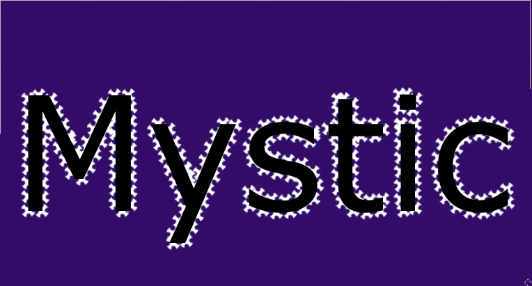

After you make your text, alpha to selection > select to path and then duplicate your black text. To to path, use your paint tool to paint. and make sure you resize your brush to your taste and try it out until you get your spacing so it is just touching the one beside it and then hit stroke
This one done with Molly's pearl to stroke
