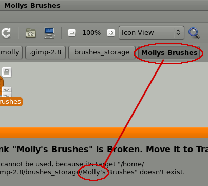

Some of my brush folders are broken. Can anyone tell me if they can be fixed? This happened last night when they wouldn't transfer over from my alternate brush folder. I am using ofnuts brush set script addon.
The broken brush shows up in this screen shot below and the message I get when I try to open it.
 Post subject: Re: My Brushes are Broken
PostPosted: Sat Apr 11, 2015 12:05 pm  (#2)
Could be that Molly's is a typo. Your folder doesn't have an apostrophe between Molly and the s, while the path has one. Remove the apostrophe from your path to the folder.

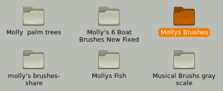

PostPosted: Sat Apr 11, 2015 12:17 pm  (#3)
Thanks, but this happened in about six of my folders and the folder shows up but all they had in them was a broken file, instead of the whole folder. I have never seen this before. I did remove the apostrophe and that didn't work either. I didn't want to lose those brushes especial because they are ones I have collected over the years and ones I made and got from GC.
This shows the folder, and inside should be all my Mollys brushes but there is just the one broken file in there

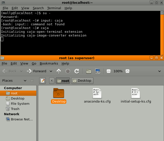

PostPosted: Sat Apr 11, 2015 5:19 pm  (#10)
ok thanks don't know what I will do when I get there though :oops:
This is what came up.
PostPosted: Sat Apr 11, 2015 5:31 pm  (#11)
You will need t browse to
File System/Home/Molly/gimp-2.8
Then to your brushes folder with the locked files. You can then right click on the file, select properties, then permissions tab. From there, you can change the files permissions to read/write.

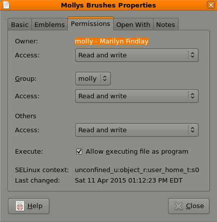

PostPosted: Sat Apr 11, 2015 5:38 pm  (#12)
They are already at read and write
This is what is says for file type... link (broken) (inode/symlink)
PostPosted: Sat Apr 11, 2015 7:42 pm  (#13)

The information I gave was instructions on how to use your file manager, as root, to change the permissions on a file/folder, which is what I thought you were wanting to do.
Looking back though this thread, I see now that you are looking at a broken symbolic link. You can think of a symbolic link as a pointer to a file or folder, not the actual file or folder itself. In your case, it appears your symbolic link is pointing to a folder that no longer exists, so it's broken. A symbolic link can become broken if the file or folder the link is pointing to has been moved, deleted or renamed.
As to why you would be using symbolic links in the first place, I wouldn't know. However, to correct a broken symbolic link, you would need to restore the file or folder the link is pointing to. In your case, the symbolic link is looking for a folder named /home/molly/.gimp-2.8/brushes_storage/Molly's Brushes. To fix the link, you would need to restore that folder.
What I find odd is that you have a symbolic link pointing back to the folder the symbolic link itself resides in. (Well, minus the apostrophe. I assumed you renamed the folder and removed the apostrophe, for some reason?)
In any event, that folder does not contain any brushes, which is what I think you are assuming. Perhaps there is another folder somewhere that actually contains the brushes and the symbolic link is supposed to be pointing to it. That's about all I can tell you without knowing more about what you are trying to do here.
