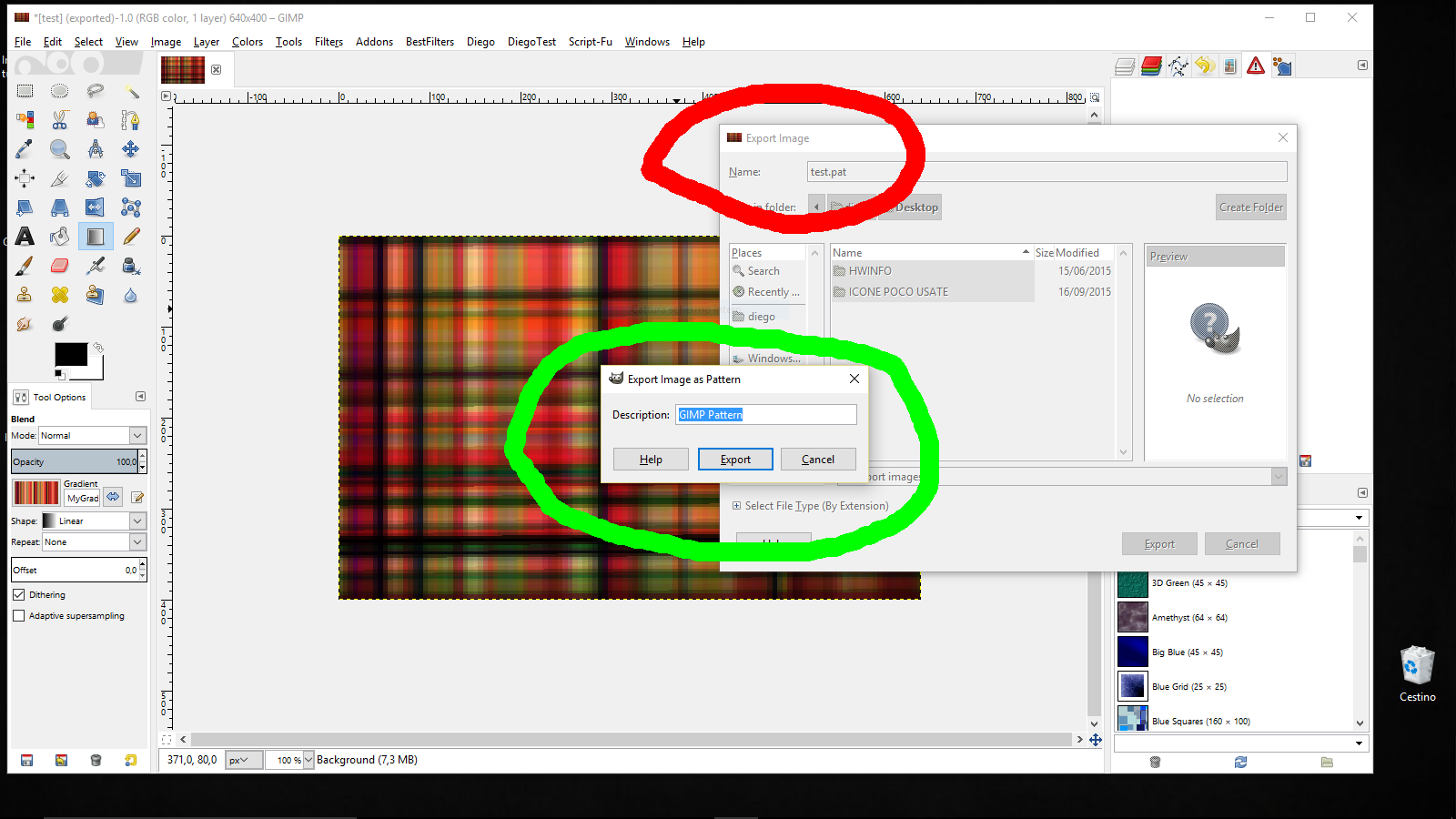

Pat, the problem you (and everybody has) is that when you create then export an image as .pat Gimp adds a description field and uses the description as pattern name instead of the file name you entered
See the attachment: the red circle indicates the name the user enters as pattern name to save, the green circle the name of the description Gimp adds

PostPosted: Thu Jul 07, 2016 9:00 am  (#6)
I had used .jpg and .png. So it must do it with those also. I have most of them fixed now. Thank you for the screenshots. I will remember to be careful of that when I use .pat also.
