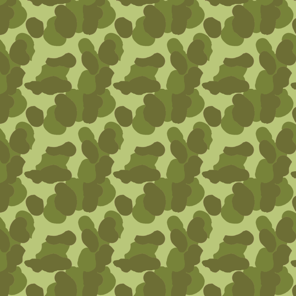

Hi, I've been trying to create an accurate texture of an old camouflage called P42 that looks like this. (I plan on fixing the artifacting in a new attempt.)
The end result I got was:
Non Seamless:
Seamless:
My question is about the second one. Is seamless supposed to look like this or have I done something wrong. If I have, what can I do to fix it? Thanks for any help.

Here's yours when used as a pattern
your non seamless used pattern.
your seamless used as pattern.
And here I played with your non seamless and manually make it seamless by drawing likely extension of shapes over the edges and cutting and pasting the extra parts on to it's opposite sides so that it is seamless.
when used as pattern
 Post subject: Re: Creating a Seamless Camouflage in Gimp
PostPosted: Mon Oct 17, 2016 2:32 am  (#3)
The second version is diffusion and its just a blend of shapes meshed together and not what most people are really looking for. Patched base makes everything looked "squared" on a larger canvas, also not what people are actually wanting. There are better methods at obtaining the camo look using seamless software like Seamless Studio (and others), unfortunately, it involves creating the actual camo shapes for the pattern, pretty much like Tin has done above. If you create the shapes as brushes, you can easily do what Tin has done and without the use of any other software.

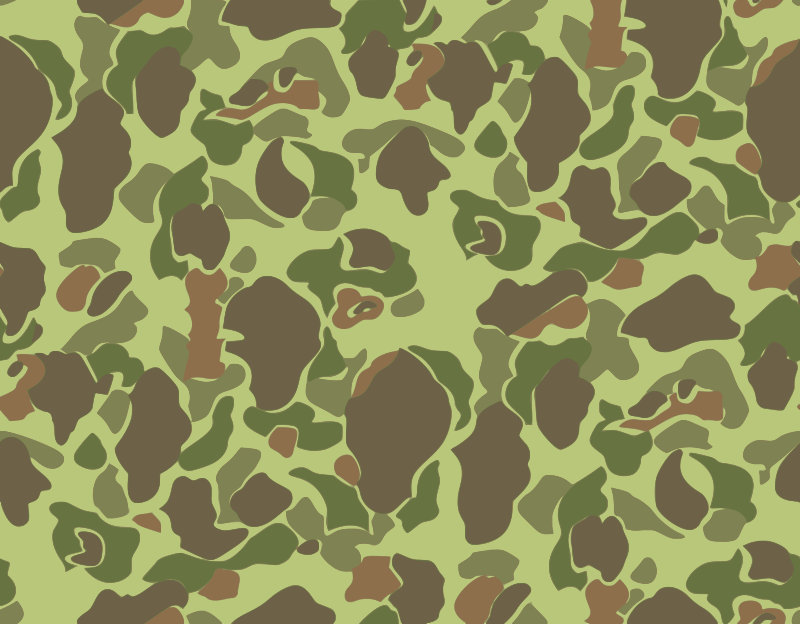

Tweaked the colours and made it into a pattern.
Duckhunter.pat [1.9 MiB]
Downloaded 259 times

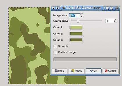

There is one already built into Gimp - been there for a long time. Makes a seamless tile.
File -> Create -> Patterns -> Camouflage
