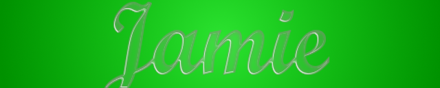

Does anyone know how i could create something like this in GIMP? I know this was created in photoshop but sure there must be a way to get close with GIMP. http://i.imgur.com/MpD3s.png
Thanks to anyone who can help.

This is very possible in Gimp.The filter "layerFX" will probably do most of it.
Grab a nice smooth cursive font
Give it an inner shadow and a inner glow
Give it a shadow for depth.
Original
Mine

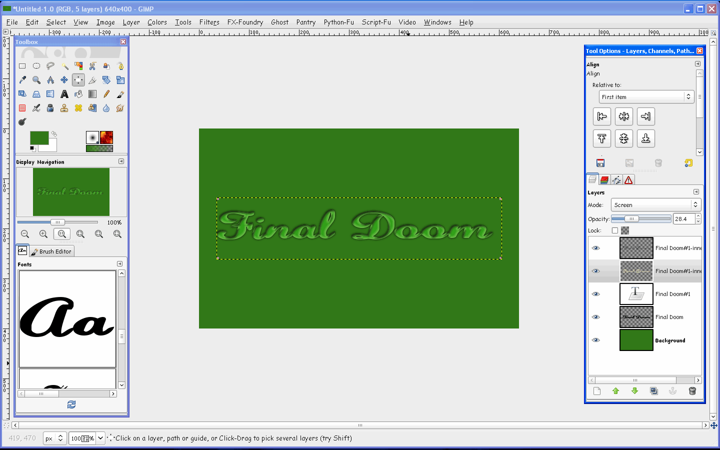

Hmmm, I tried this but it doesn't look good. Can you add a few intermediate steps and settings?

Oh, btw, any clue to the name of the fonts in both the "original" and the "Rod's version"? And Rod, did you start with black text and what color did you use for the inner glow? I did use the layer fx but sort of failed trying to use the settings, lol. I couldn't get the highlights to be on the upper corners only.

Sorry 2-ton i forgot the name of the font.The color for the inner glow is the default, and i used black text to start.
Then i did an alpha to selection>edit> clear - with the text still selected i ran the layerFX.
I will post the font face when i find it again, as i didn't save the xcf file. (i have over 2k fonts so...) :)
The blur for the drop shadow is set at 7 and dropped down 4 pixels "bottom-> right"
I created a duplicate of the text for a drop shadow (no script)
As for the settings for the LayerFX inner glow, and inner shadow...all default pretty much.It is going to depend on text size (mine was 165)
Doc size is 640x480

Wow Rod thanks Image Not bad very close!
