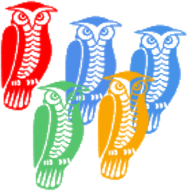

I downloaded and looked at the Little Birdie brushes. They are all grayscale gbr brushes which means they will take on the foreground color or you can use a gradient to color them.
Unfortunately, it shows prettily colored birds but that's not what you get. The valentine brushes are the same way - grayscale and they take on either the foreground color or gradient colors.
Here's brush 10 which is an owl that I used with a gradient. You can see that they come out solid colored rather than various colors like it shows in the picture of them. It kind of ruined the brushes in my opinion.
Anyway, if your foreground color is black, either brush will come out in shades of black and gray. It's not your fault, it's the way the brushes were made.
You can use a single color (I used black) to paint the brush, then make a new transparent layer under the brush and paint in some of the empty spaces with color.
