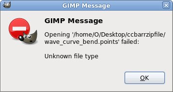

ccbarr wrote:
click on the Open button and then open the folder containing the unzipped file I added to load my Curve Bend curve file.
Your file has no extension it, ccbarr, and GIMP does not recognize it.
