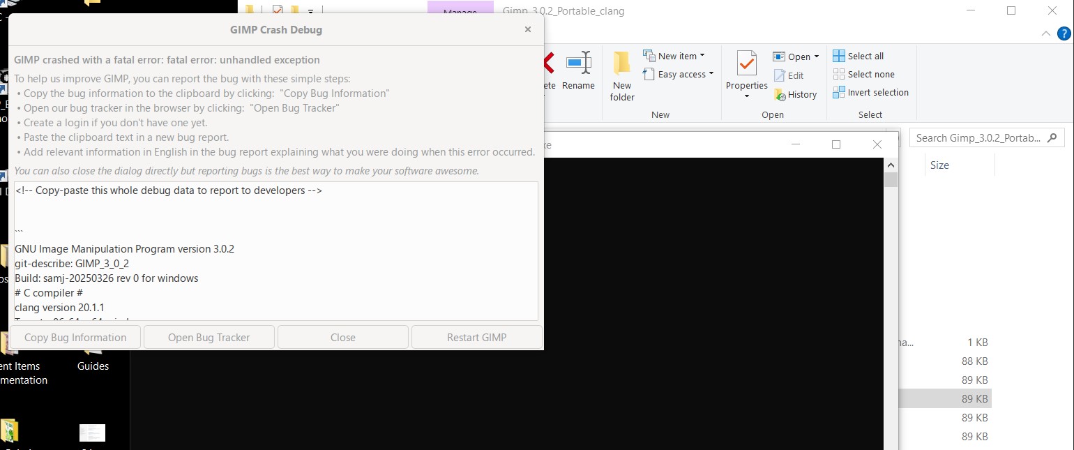

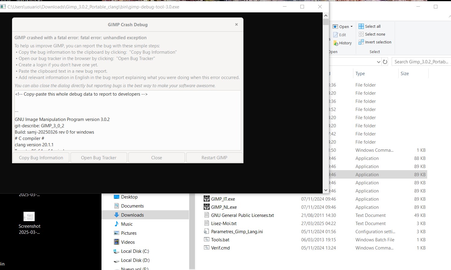

While running the program in EN as usual, almost at the beginning, the "crash" warning appears.
In another tutorial, I was told to remove all previous Gimp software, all from previous versions of GIMP. I did it and I removed it and put it on a separate drive.
I tried again, and the same thing. I was not able to get it to run.
Here some of the warnings.
Thanks for your help.

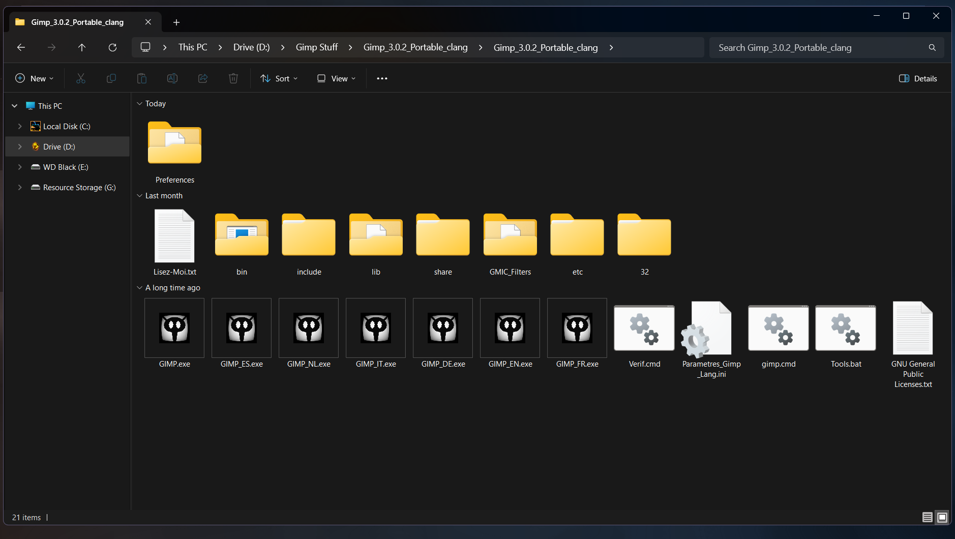

Maybe try a different location to unpack as administrator, e.g. d:\Gimp_3.0.2_Portable_clang (works without problems for me).

I unpacked the files and moved them to my D drive.
Then ran the each exe file.
It seems the ES.exe version was the only exe file that did not function correctly.
All the other language versions opened correctly without fail.
Oddly enough the ES version fails to open.

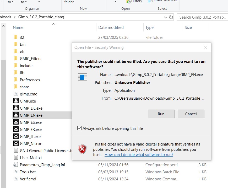

Windows also gave me a Unknown Publisher Warning when I ran each version.
Which is normal windows behavior for these files.
I didn't get a unhandled exception error as you did.
This would leaves me to believe that there may be something missing from the ES version.

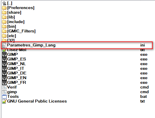

Attempting to launch it via GIMP_ES.exe will not only fail, but will also prevent any other attempt to launch Gimp3.
To confirm:
after restarting your computer try launching 'Gimp_3.0.2_Portable_clang' using GIMP.exe.
But this is easy to fix.
There is a bug in the Parametres_Gimp_Lang.ini file.
Solution:
just replace:
GIMP_EXE=gimp-2.99.exe
with:
GIMP_EXE=gimp-3.exe
This little mistake doesn't explain the problems with unpacking though (if I understand correctly: because in this case, installing means unpacking, not running Gimp). ;)

What you did shouldn't work at all (and without any worries it may be the cause of some configuration problems). :mrgreen:
The samj version has a few starters for different languages ​​and a text file Parametres_Gimp_Lang.ini.
There was one error in this file - specifically for the _ES language, and using it without correction is so flawed that it suspends any Gimp3 launch.
Attached is the Parametres_Gimp_Lang.ini file corrected in line 87.
